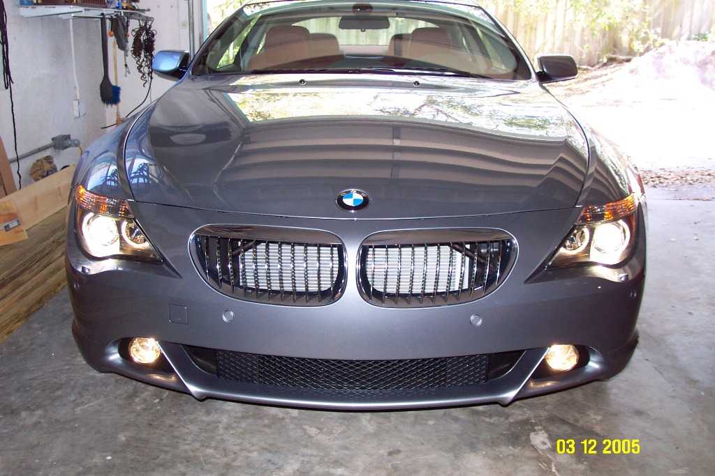

I did,
Before

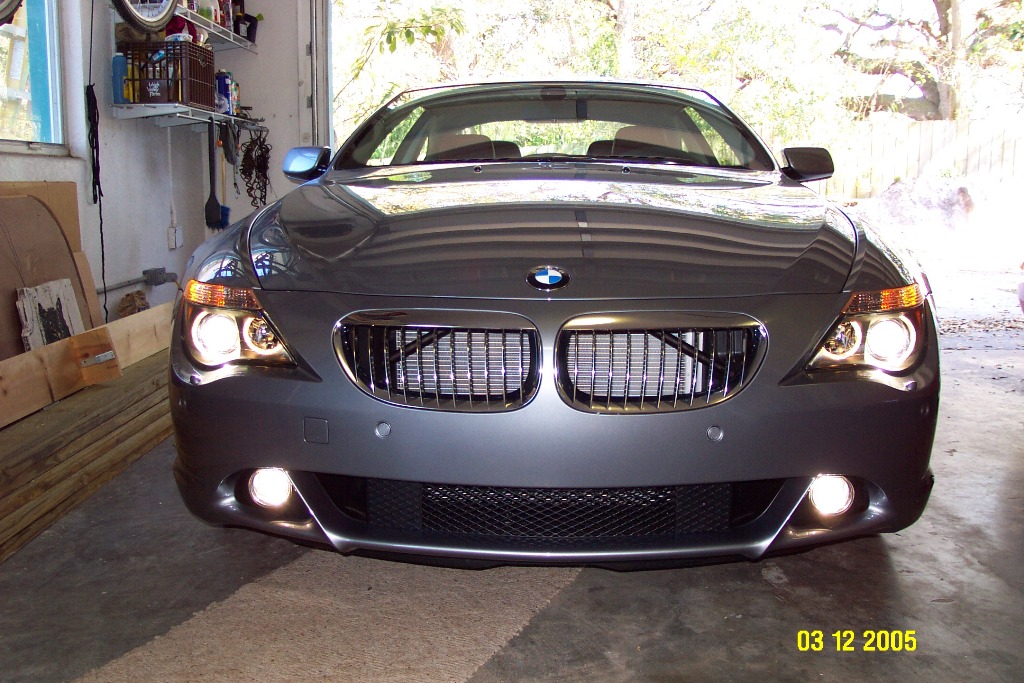

After with Superwhite 4100K I think it is a close enough match and retains as much fog piercing light as I need here in not too foggy Florida.
