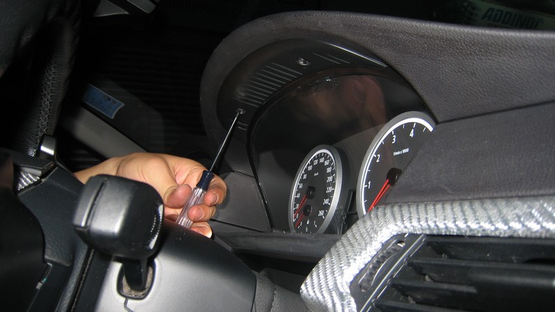

Hi guys im looking to remove my cluster from my car does any body how it comes out and what needs to be removed
Any one have a diy guide with pics?
Thanks in advance looked around on the net no luck so far...

There's a DIY guide on here, but I am too lazy to search for it right now.
It's pretty easy. There's two screws holding it on top, and then a harness that needs to be unclipped in the back.

Yup, I did this one last year.....Thanks to pinguhk for the pics.
https://5series.net/forums/topic/715...ok-like-m5-or/
Attached Thumbnails How to remove cluster on 530d-002_changing_white_led_on_cluster.jpg
