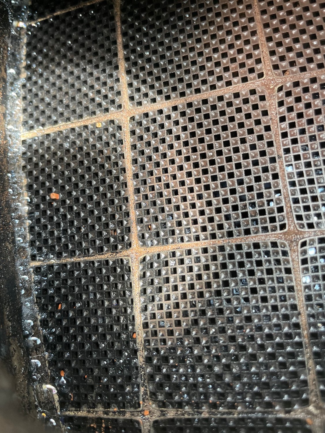

Here's a pic of the cells in the DPF, taken at the water rinsing phase. You can see the bubbles coming out of the cells and water dragging into them:

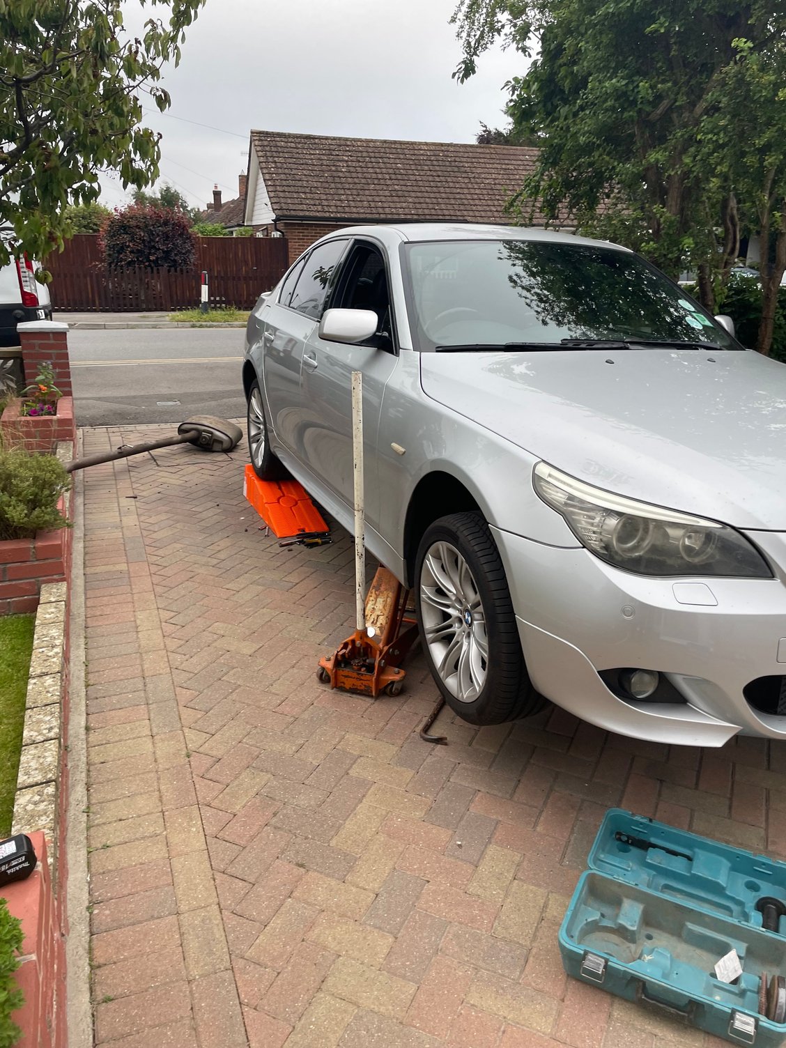

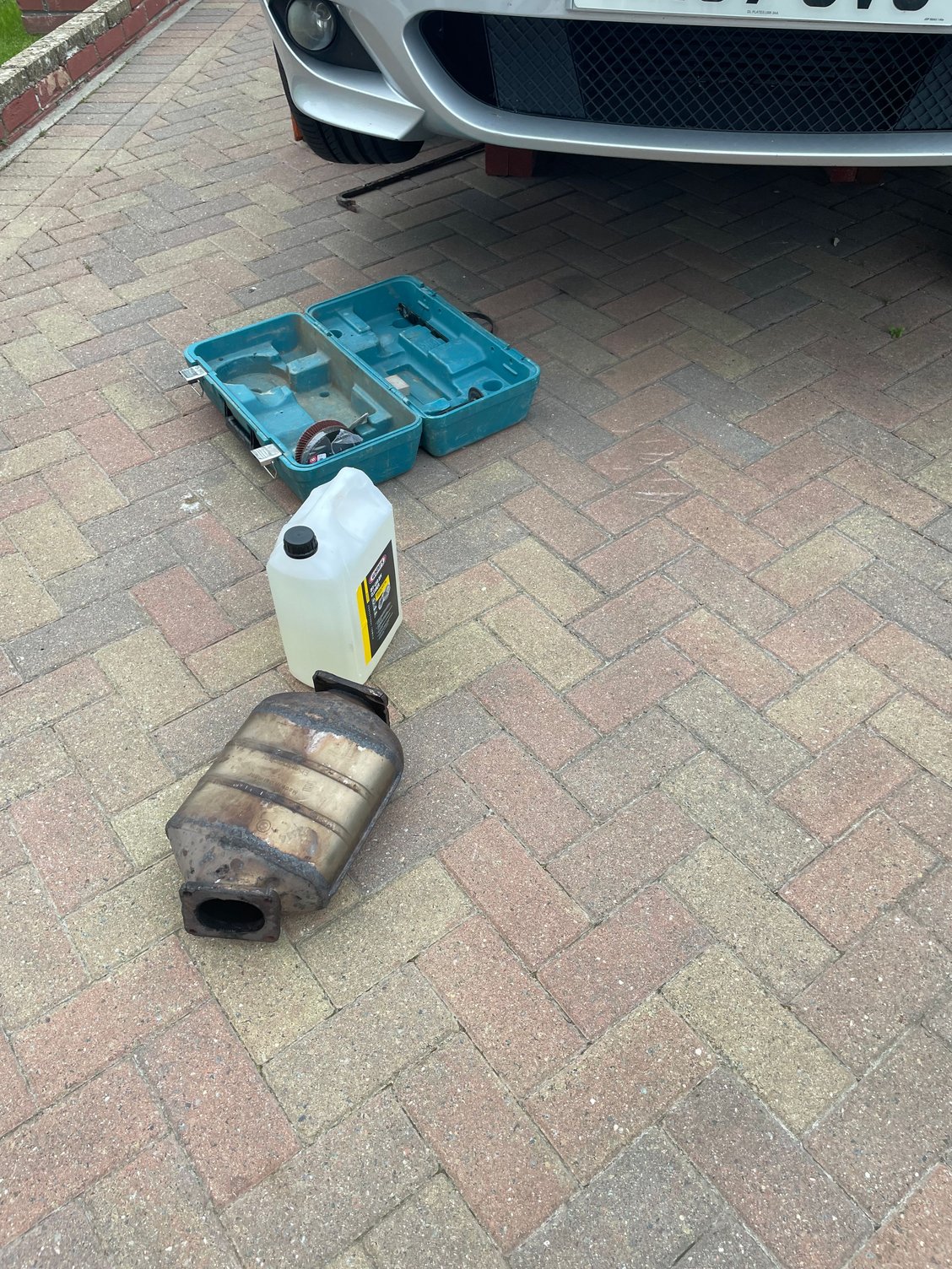

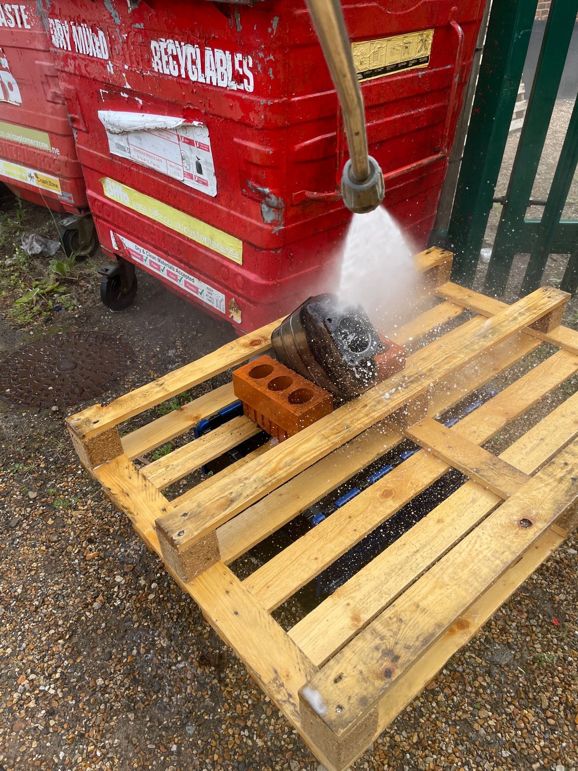

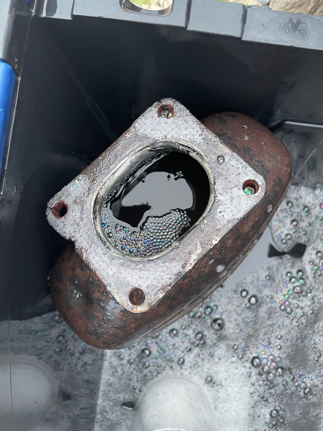

I’ve just cleaned my 520 2007 dpf filter exactly the same way you’ve done as it has 155k on the clock and recently it was showing dpf faults (could be too high mileage on the original dpf).
Refitted it yesterday and now the back pressure on idle it’s around 0-3mbar. I think it worked but time will tell.
Ash coming out
Ash coming out

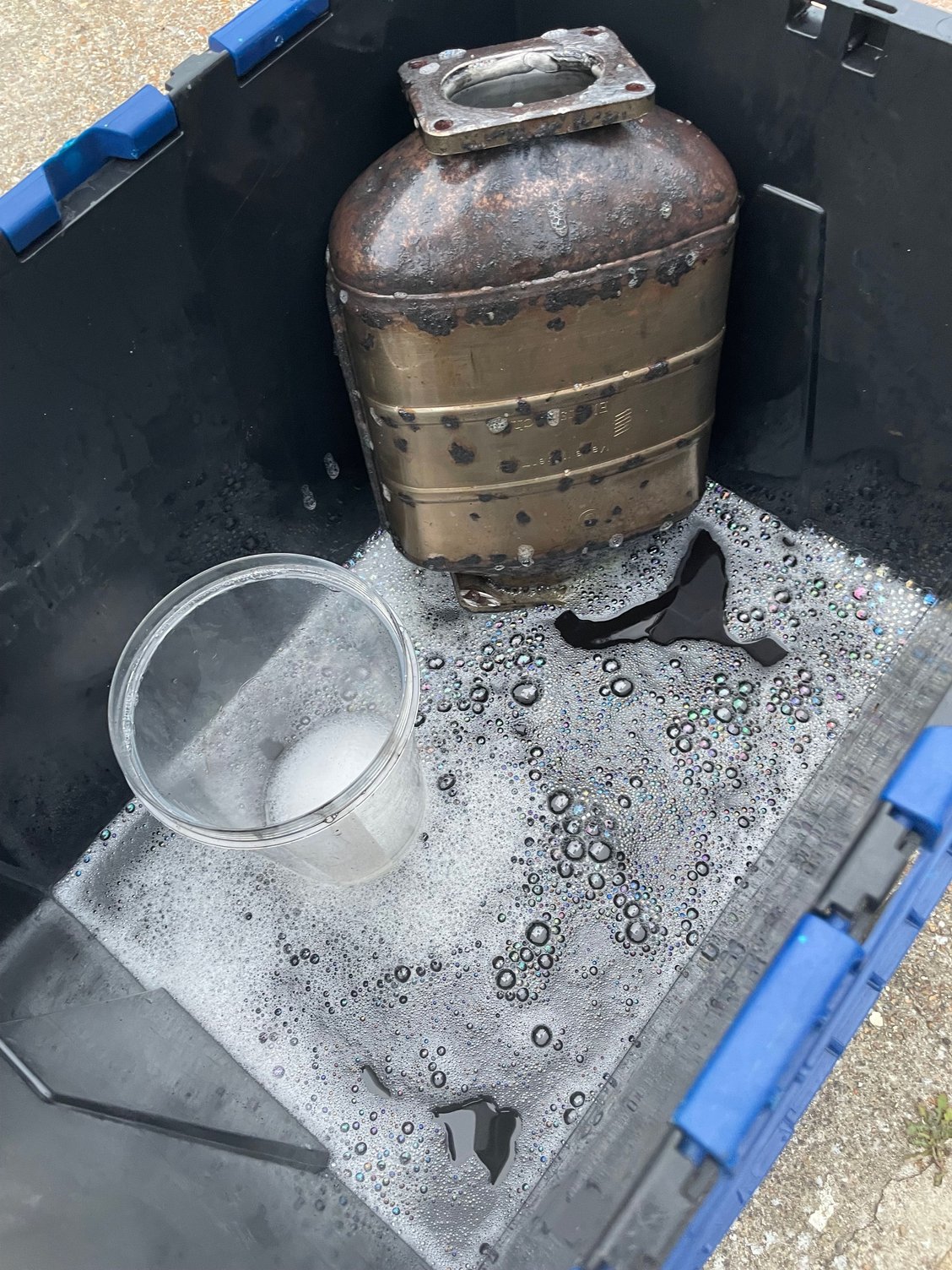

Warm pressure water wash
Soaking it with chemical

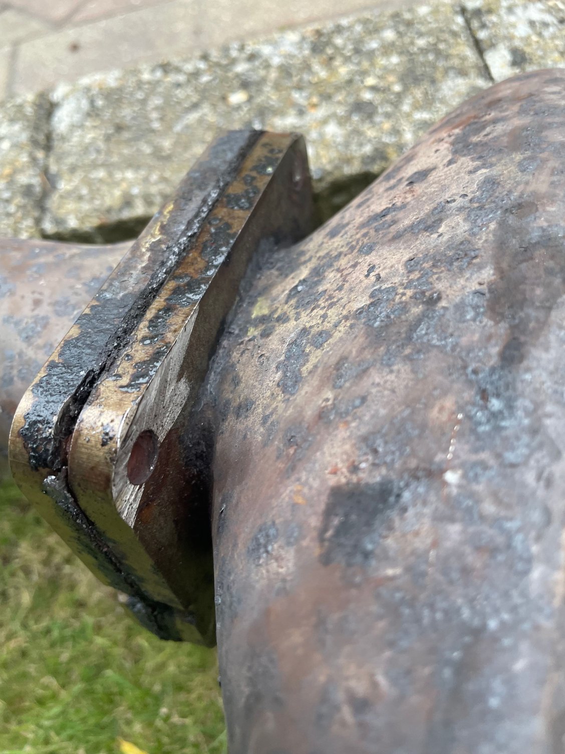

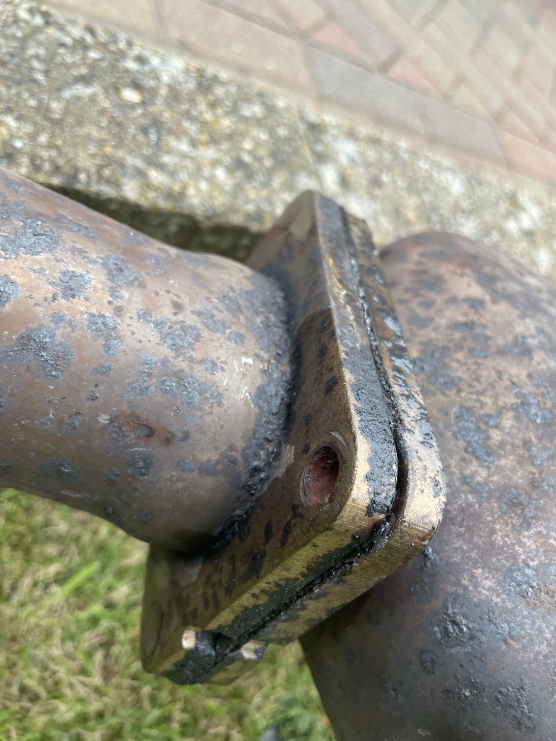

Bolts were gone, had to cut them on both sides-16 cuts

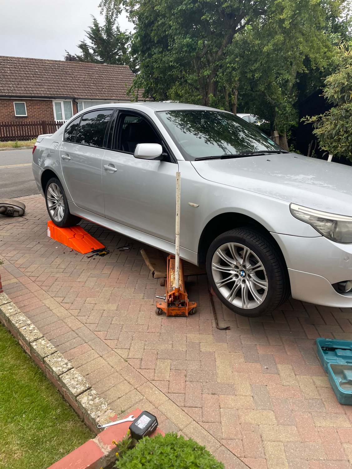

Beast on jacks 😅 had remove all of exhaust pipe from the catalytic clamp as not able to cut dpf bolts otherwise
Beast on jacks 😅 had remove all of exhaust pipe from the catalytic clamp as not able to.Please feel free to comment or ask questions!
