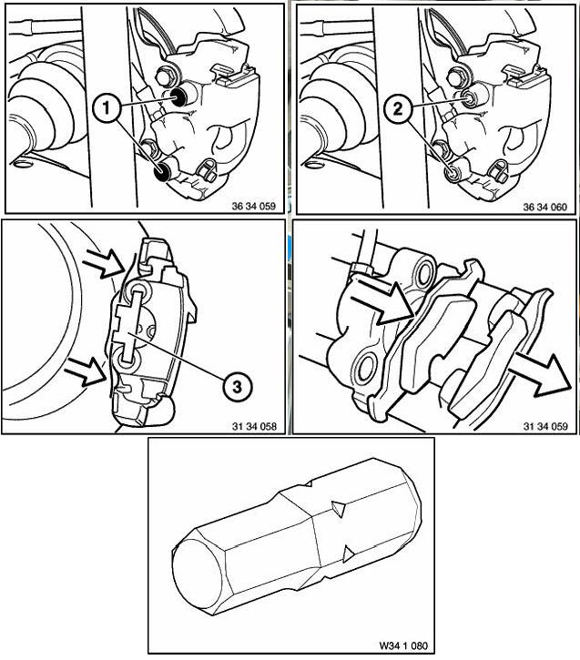

Originally Posted by Rizbel' post='915876' date='Jun 18 2009, 02:15 PM
Attachment 82335
You need a 7mm Tool Hex adaptor or similar, available at local Pepboys or Autozone. Remove plastic caps #1 on picture, unscrew pin guides.
Remove spring retainer, #3. Withdraw brake caliper backwards. Remove old pads. Turn piston back(with open bleed valve, of course) and put new pads(bleed system afterward). Reinstall spring, pin guides and caliper onto carrier.
Sensors at front-left and Rear-right only.
87 ft-lbs ?7.
If you don't know how to accomplish that, please don't do this project.
