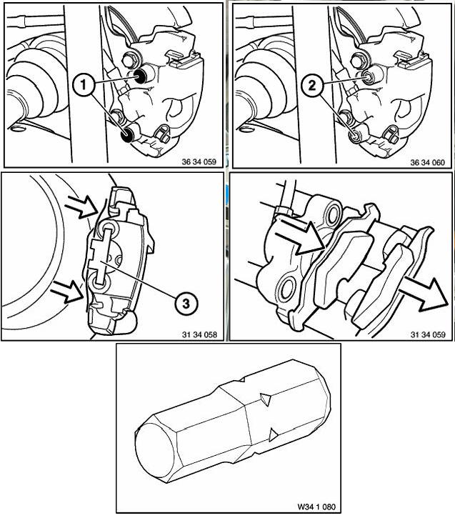

You need a 7mm Tool Hex adaptor or similar, available at local Pepboys or Autozone. Remove plastic caps #1 on picture, unscrew pin guides.
Remove spring retainer, #3. Withdraw brake caliper backwards. Remove old pads. Turn piston back(with open bleed valve, of course) and put new pads(bleed system afterward). Reinstall spring, pin guides and caliper onto carrier.

Thanks for the info since I don't have the benefit of a car lift I could not get far enough inside to see. The picture provided appears to be for the rear pads, but I have the pdf already for the front pad replacement instructions found elsewhere.
