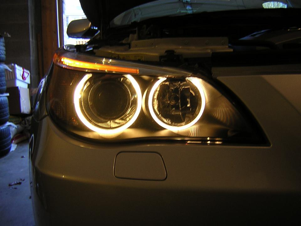

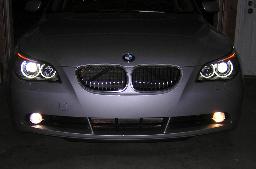

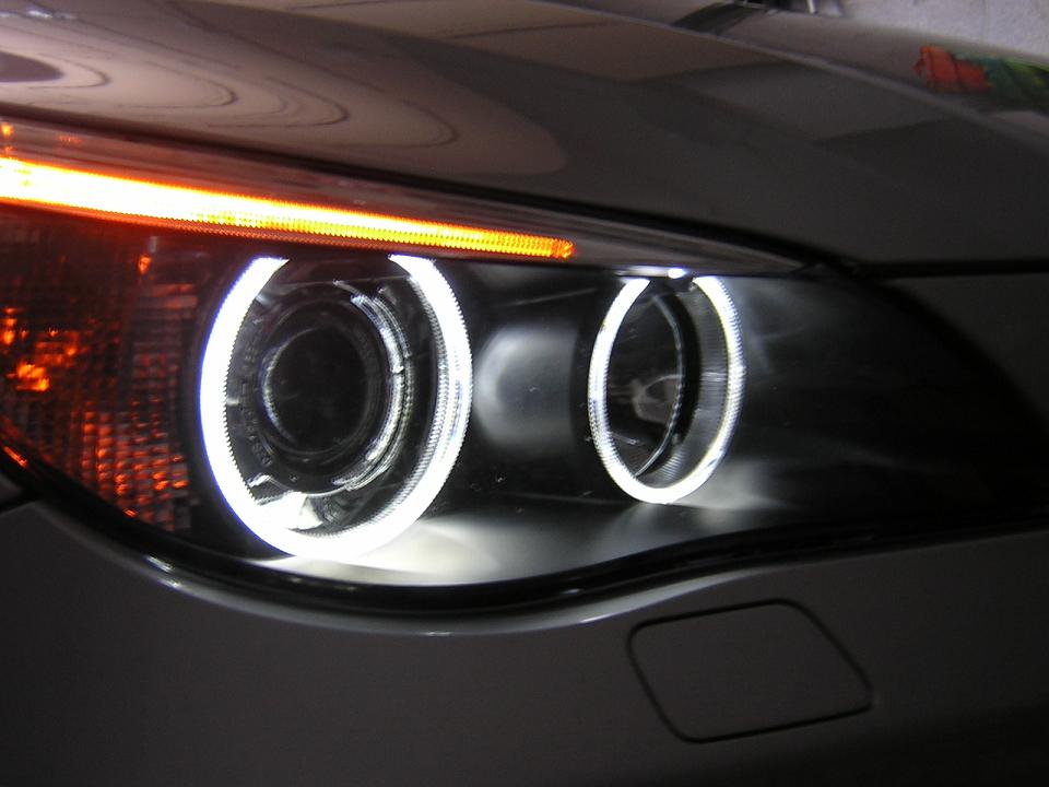

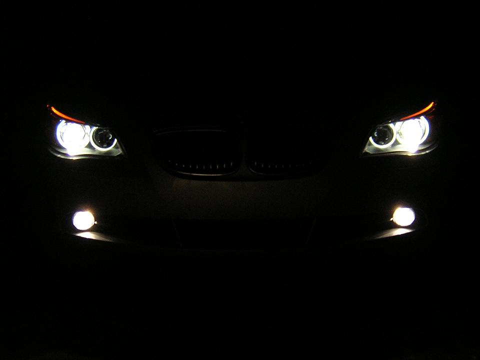

Just did AIB v3.0's myself without removing the headlight assembly. Once I got the left one done, the right was a snap. Due to the learning curve, the left took about 40 minutes, the right took 15! I used some longer needle nose pliers as well as some normal pliers. I scratched up the old ones a bit, but who cares (they are real junk). And it was actually very easy to pop the new ones in and give that slight turn to tighten.
For those of you considering taking off your entire headlight assembly, forget it...not necessary. Just remove the radiator cover with a torx 25 bit and a drill to give you more room to move. That part was real easy!
And whalla, all done.
I also did my FOGS today with Hoen lights recommended by C's Bimmer (pics 5 & 6: left OEM, right HOEN). Give a look!
Thanks to all those who gave me advice, like Calton and JRV550i (whose DIY above was great!) and others who posted DIY's in the past!
Some before and after's....
