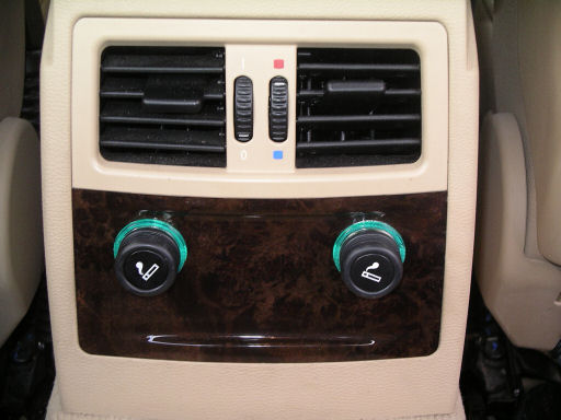

I've now fitted the twin-socket 12V outlet and done all the wiring as per previous posts on this thread and everything works fine. The spade connectors in the fuse box area are pretty small so if anybody else is going to do the same job just bear that in mind. Overall the socket plat and the four blanking plates needed (yes - four!) cost around 20 pounds but it's a nice job IMHO.

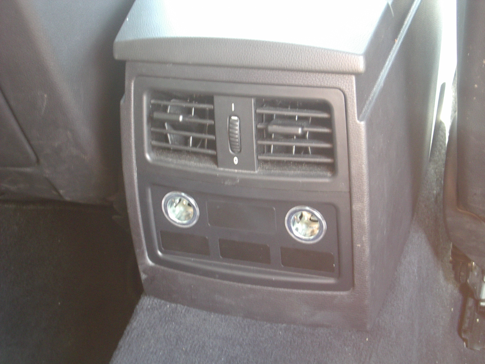

If you do not want to fit blanking plates, and want a more streamlined look, you should buy a solid back plate and drill your own holes for the sockets. The plate already has the position for them on the rear of the socket, so you can drill from behind to get them in the correct position. If you use a large wood bit drill, drill halfway through, before you break through the front, turn the panel around and drill back through from the front. This will prevent the facia from splitting. I have done this on a wood facia. I will post pictures later.

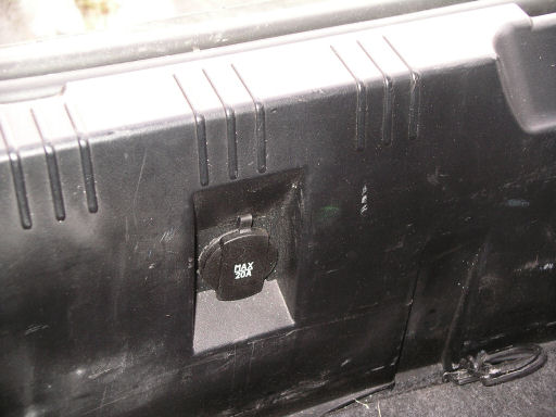

Here are the pics of my installation. I have also fitted an extra socket in the boot. This is handy for my cool box or compressor.12v Power Outlet fitted-imgp3733.jpg12v Power Outlet fitted-imgp3734.jpg
