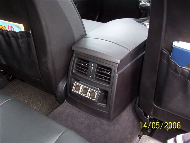

I've now fitted a triple 12v outlet socket in the rear. I mounted it in the recess at the back of the centre console between the seats so it doesn't stick out too much.
The main reason for this was the kids didn't have anywhere to plug in their Gameboys or Portable DVD player other than the cigarette lighter in the front.

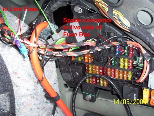

Also, as the front socket doesn't stay live when the ignition is switched to accessories, I wired the new triple socket to a spare fuse in the boot. (Fuse number 87 to be precise).

Here are the photos I promised.
The job itself was easy enough, just time consuming. Firstly I removed the rear seat base. Then I popped out the recessed "coin bin" from the back of the console, and mounted the triple socket using the double sided tape that came with it. I then ran the wires down through the gap (underneath the rubber pad) and then underneath the carpet to the centre of the back seat. (Managed to get enough of a gap to push a long nylon cable tie underneath the carpet from the centre console, and then taped the wires to it before pulling them through).
Removed the rear set upright to get to the earthing point (behind the seat back) and to run an extension wire through to the boot (via the same route as the wiring loom). Once all the wires had been run , I just added an in-line fuse for good measure and used a spade connector for the live feed from the front of the fusebox on fuse number 87.
I must admit it's not the prettiest of jobs, but sure is functional.

Originally Posted by Kev525' post='282348' date='May 14 2006, 10:30 PM
You do realise you can buy a part from BMW that goes where that cubby whole is and gives you 2 12v sockets.
Would look alot neater and only take 2 minutes to add now you have routed the cabling there already.

The triple socket was only ?3.50 and the whole job only cost me about ?6 in total, so given that I'm not that bothered about how it looks, I'll pass on the OEM part for now.
