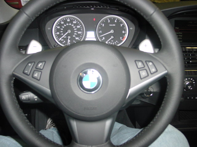

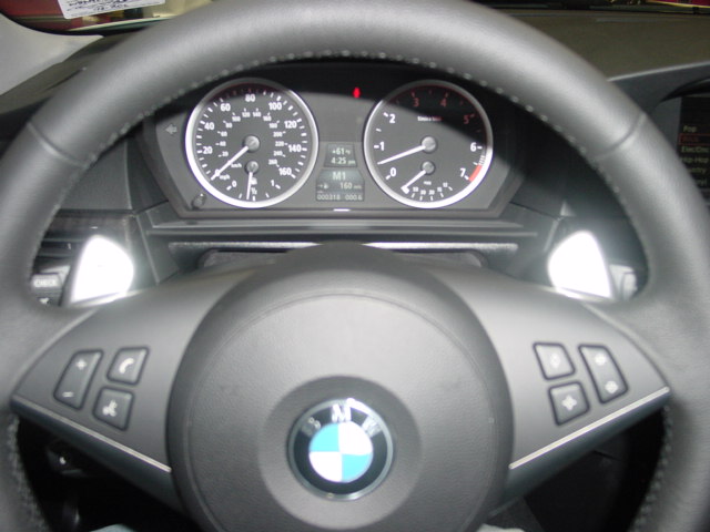

Did this mod to my 550i. it took about an hour to do, using Fred's kit + parts from BMW.
SMG s/w, M5 paddles and Fred's kit ran $1280. Our local BMW dealer gives 15% off for BMWCCA members.
Running the harness from the console to the steering wheel was not bad.
M5 paddles on a SMG steering wheel, stock steptronic shifter.

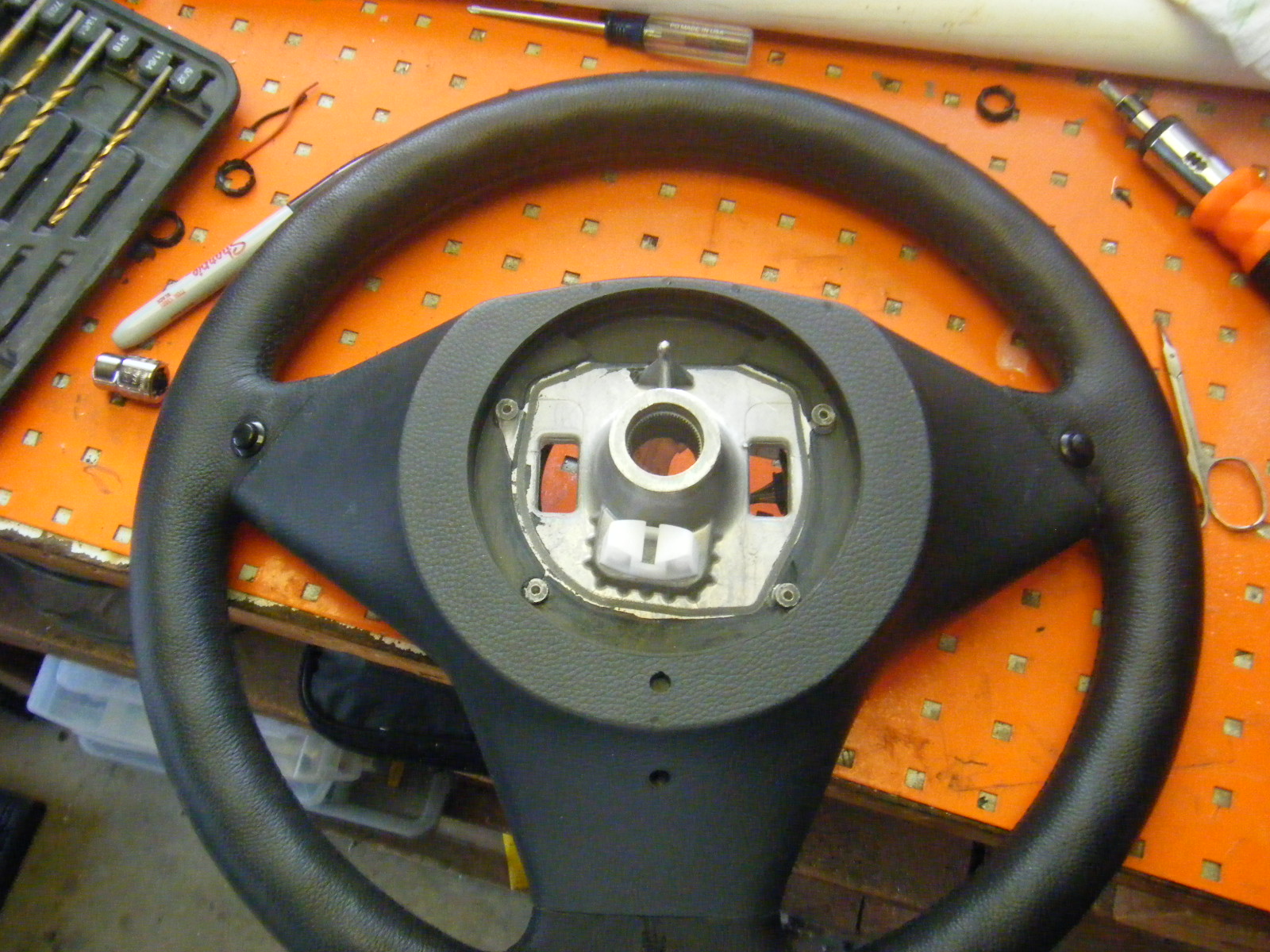

Originally Posted by 650miles' post='728511' date='Nov 22 2008, 01:01 PM
So, does this mean you think you can complete this mod without using the other kit being offered on the board? If so, do you plan on sharing your results, or at least offering something a littel more competitive in price?
Not knocking the kit that's already out there in any way, but in many ways capitalism is a great thing...
You can do this mod without the "other" kit. umm i don't know about offering a kit myself as i'm all for sharing information with fellow entusiasts rather than profiting from it. It's an option I guess if you don't feel comfortable doing it yourself. i'll share the info and pics for sure, which was the whole point of this and once you see it, you just might feel comfortable enough doing it yourself.
Also keep in mind that I modded my existing steering wheel to make this work (Pic attached) and did NOT use a SMG steering wheel. Going to grad school in Jan and just didn't want to spend the 700+ on an SMG wheel but the principle is exactly the same I pretty much hardwired most of my stuff but adding connectors to make it reversable in case you want to take it out is just as easy.
sadly, i don't understand why anybody else wasn't willing to share how to do it but i also see the point that they wanted to protect someone that they had purchased a product from. If there hadn't been such a lack in response from the originator making the kits, I probably would have just bought the kit and dismissed it as i've been tinkering with this for ever now. Last night however, around 4AM and after many many Wild Turkey-Cokes, I tore everything appart again and it was just so simple. Anyway, really doesn't matter anymore.
I guess the lesson learned here is, as much as I hate to say it, listen to your elders. Had I listened to my old man from the beginning, I would have had the solution wihting the first hour of taking the car appart
