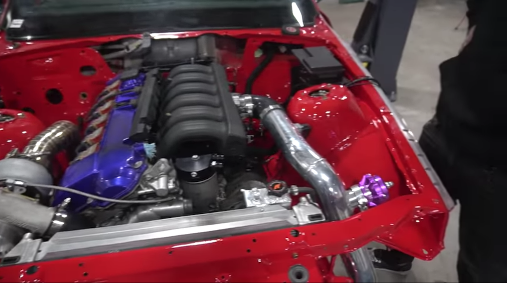

With the chassis wiring finished, up next is the engine wiring harness. Upon inspecting the harness, Oakes shares that the only thing that doesn’t line up is the ECU connector. Diving into the wiring for the engine also revealed a much easier procedure for the crew than originally anticipated.
E36 Datalink
For one, they can simply run the main positive wire behind the firewall and out of the way. Also, the Datalink connector attached to the harness can be chucked completely since the team is running a standalone ECU. Ultimately, they’re able to slim down the wiring harness a considerable amount and keep things nice and neat in that sparkly little engine bay.

With the wiring done, Oakes pulls out the secret sauce. “So this is supposed to be the best intake manifold out of all the E36 engines,” says Oakes “It just makes the most power, basically because it has some fat, long runners on it… this is the intake to have.” The aforementioned intake manifold comes from an M50.
On top of the added performance, the M50 intake manifold hides the harness quite nicely. Gotta love a good double-dip.
Next, the crew starts to slap on the front-end components. And, no surprise, the chassis radiator mount is brilliantly painted to match the bay. With the radiator and intercooler in place, the E36 build is looking better than ever.
