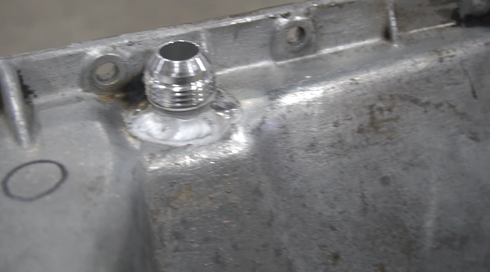

Before the crew drops in the engine, they elect to weld an oil drain bung onto the oil pan. After doing so, they replace the oil pan gasket and re-install the pan cover. Oakes also mentions the need to skim coat the gasket with RTV to prevent common leaks.
