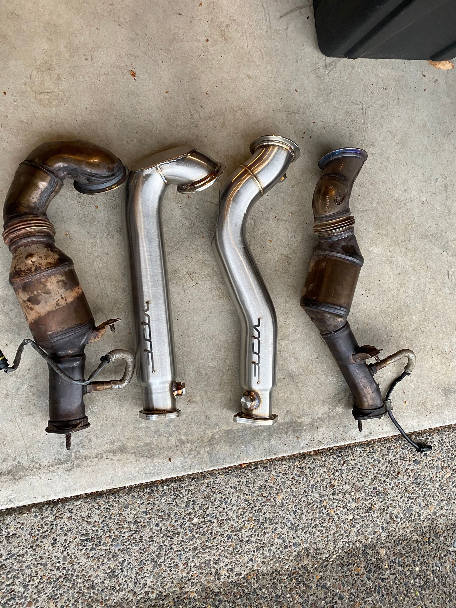

I purchased VRSF DP a few months ago.

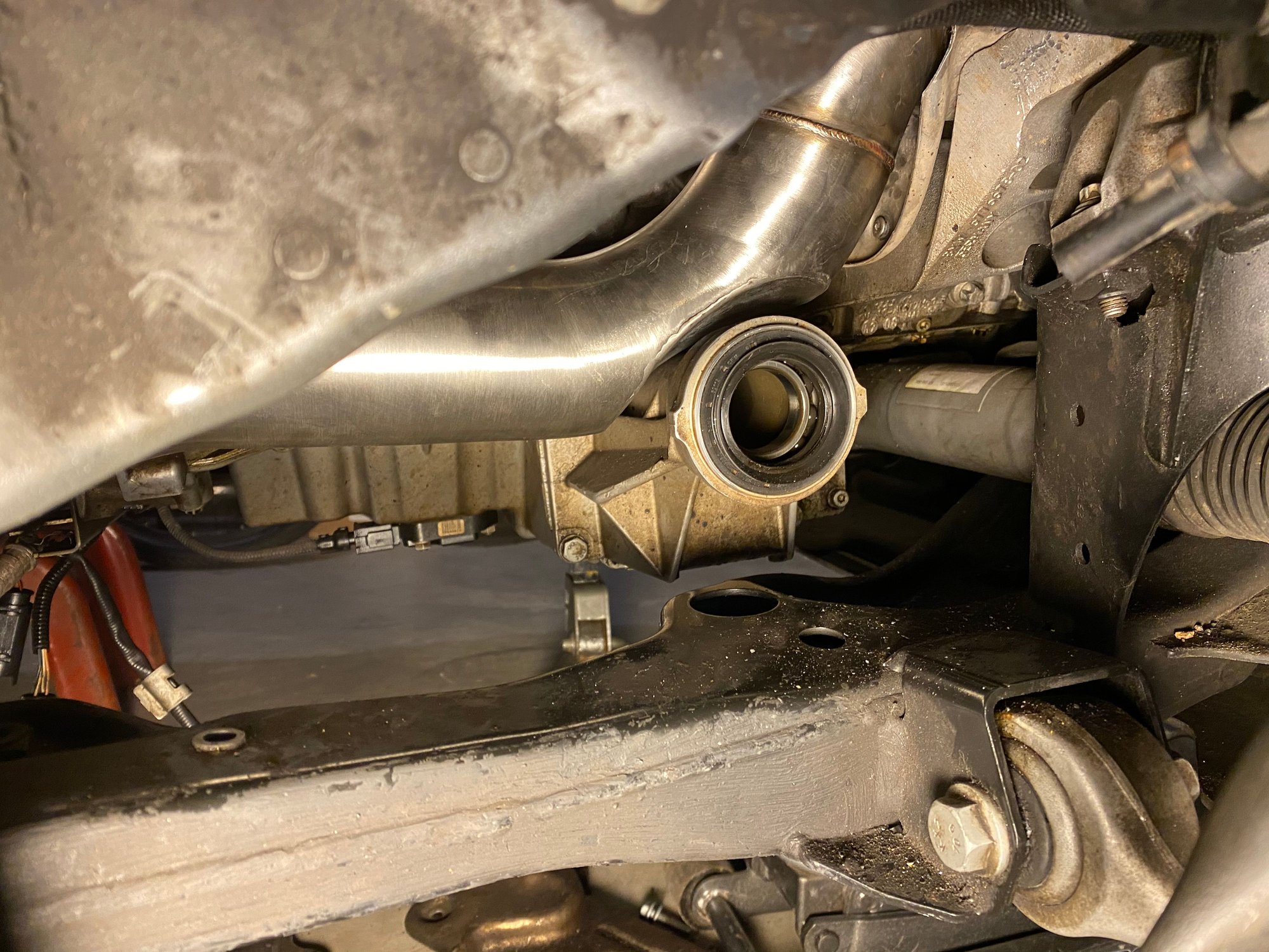

Mine didn't fit well at all. I had to go to a muffler/welding shop and the guy (also a BMW enthusiast) said that flanges on VRSF downpipes were welded crookedly. After a few seconds of considerations, I asked my welder to delete secondary cats.
VRSF next to stock
I removed front axle because it needed to replaced.
Making some changes.
I the end of the day, they are not so bad. Whoever will decide to buy them for their xDrive E60/E61 be prepared for PITA installation.

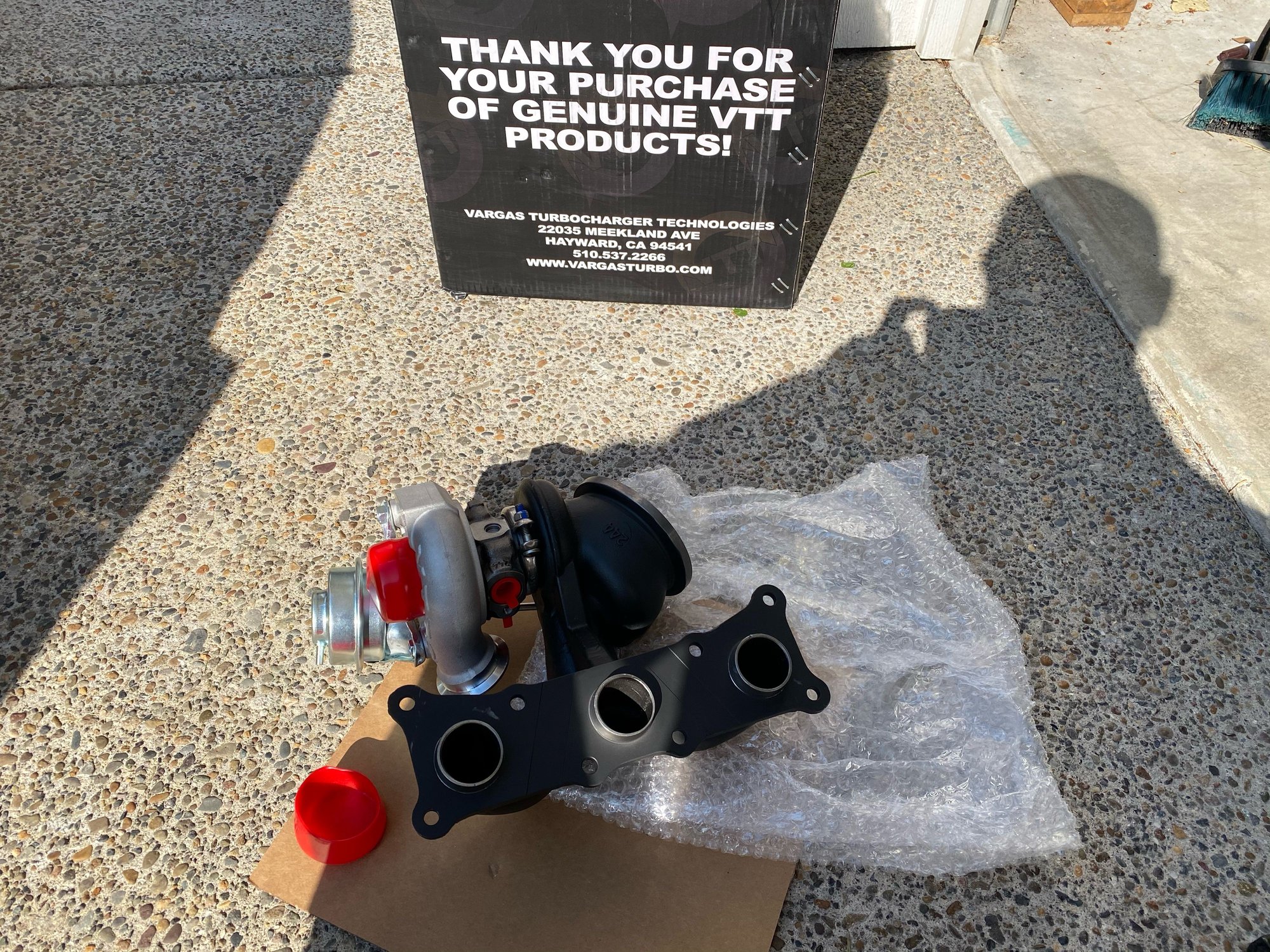

I bought Vargas stage 2 turbos and waiting for them to be installed. Not sure if I want to mess with my xDrive system, I like the grip of all 4 wheels.

My turbo setup is done. But I don’t drive this E61 now, I’m waiting for headlights to come back with renewed internals - waiting two months already.
Yes, Vargas offer the rebuild option. Not sure about the prices. I wanted something right away available.
