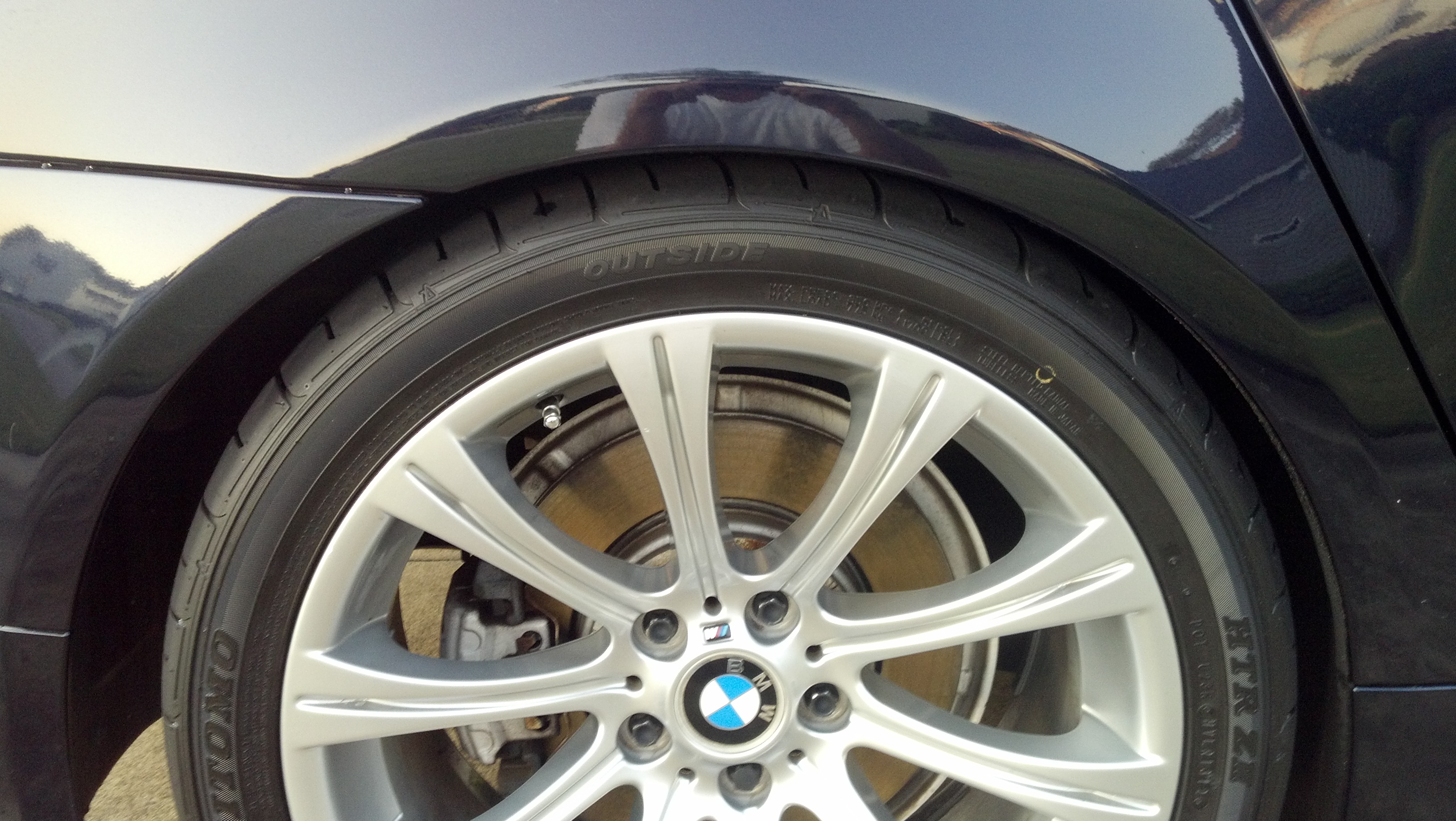

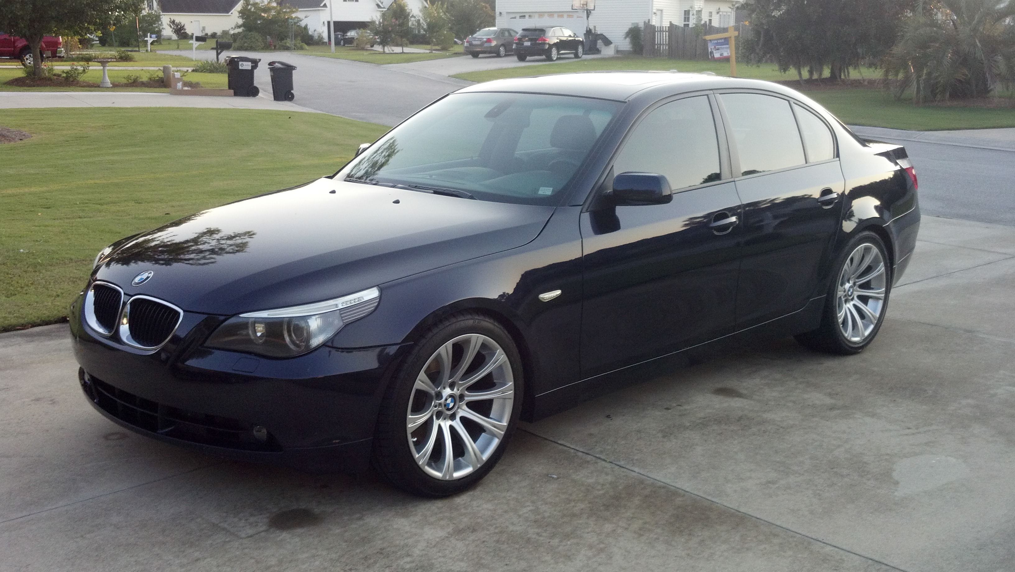

Attached you'll see the setup on my 06' 530 with Sport Suspension.
Wheels are OEM 166's 19 x 8.5 Front and 19 x 9.5 back
Tires are:
Front: Continental DW's 245/40/19
Rear: Sumitomo ZIII's 285/35/19
My fronts rub a little if i encounter a deep dip, but it's not too bad, and i think if i can get a little of the tread off, i won't have that issue anymore. I had some 12.5mm spacers on the rears, but those rubbed slightly when i got the new rubber on the back so I took them off. I might give them another try after the tires wear a little. Generally happy with the setup, the Continentals are a little soft on turn in, but I wanted some rim protection for my beauties! Thinking about 255/35/19's next time around, but I hope by then to have some KW Street Comfort coilovers installed to elimanate the gap that will leave...

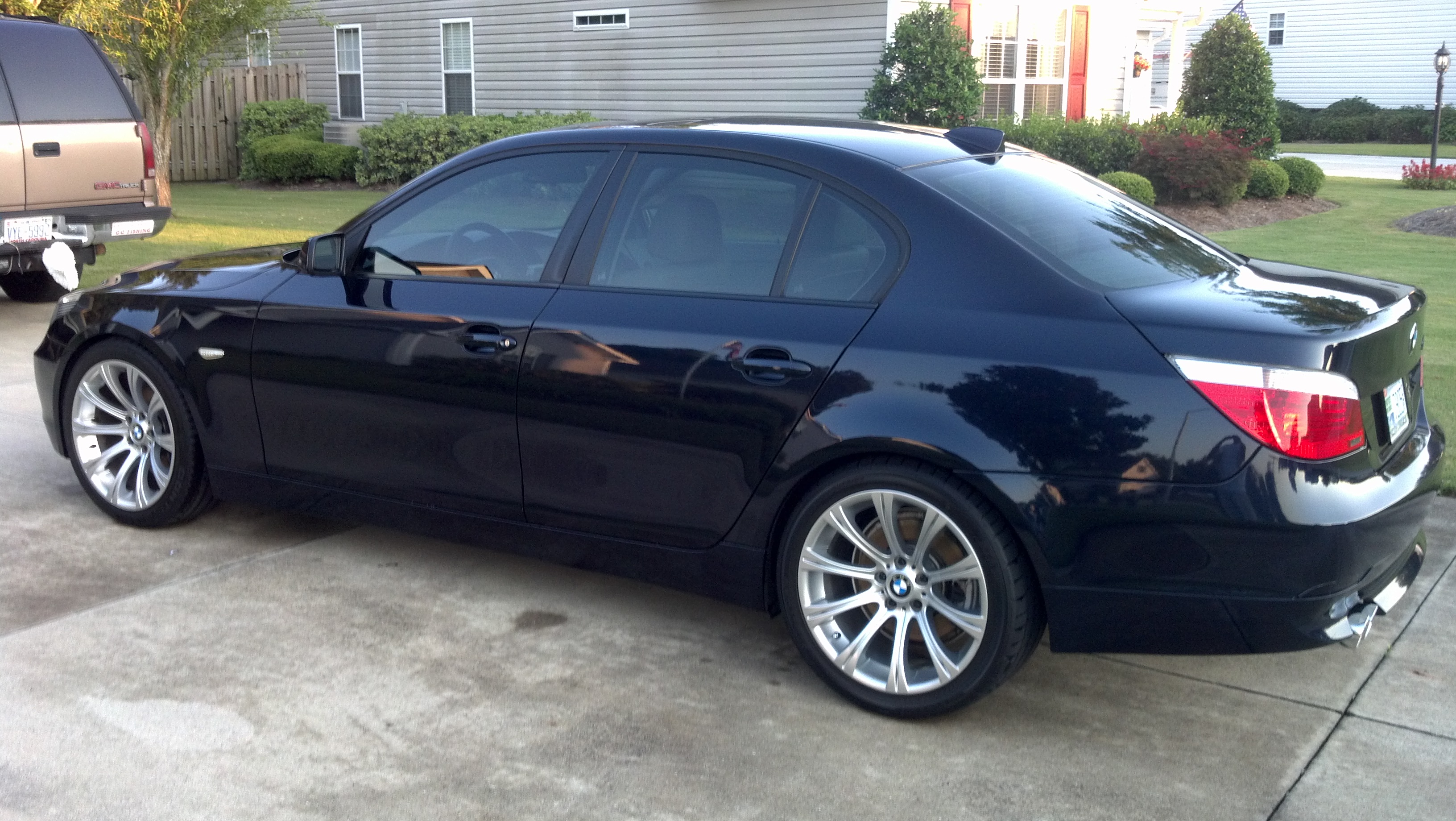

Here we go, some full side shots:
Attached Thumbnails Style 166 on non m5-2012-06-28_19-54-21_525.jpg   Style 166 on non m5-2012-06-28_19-54-33_692.jpg   Style 166 on non m5-2012-06-28_19-52-01_586.jpg
