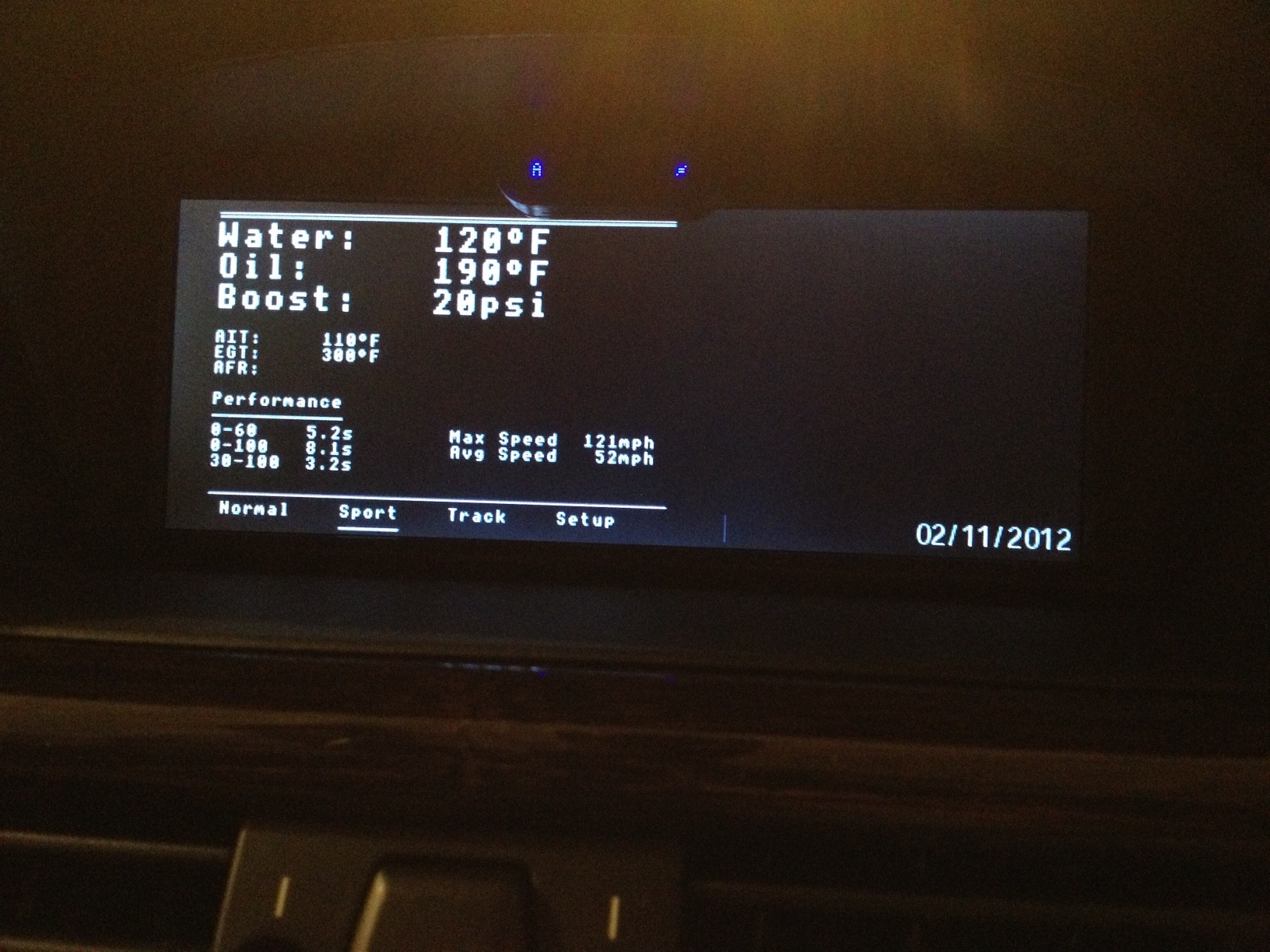

miDrive is a computer module I have custom made for my 2008 535xi. It connects directly to the computer network in the car (called the canbus) and displays things like oil temp, water temp, etc on the iDrive screen. I can control the interface with the iDrive knob and a simple menu system. Below is a pic that shows one of the screens.
I have 2 units assembled and will be ready for beta testing after I give them a thorough testing in my own car. The third one in the pic is my own
