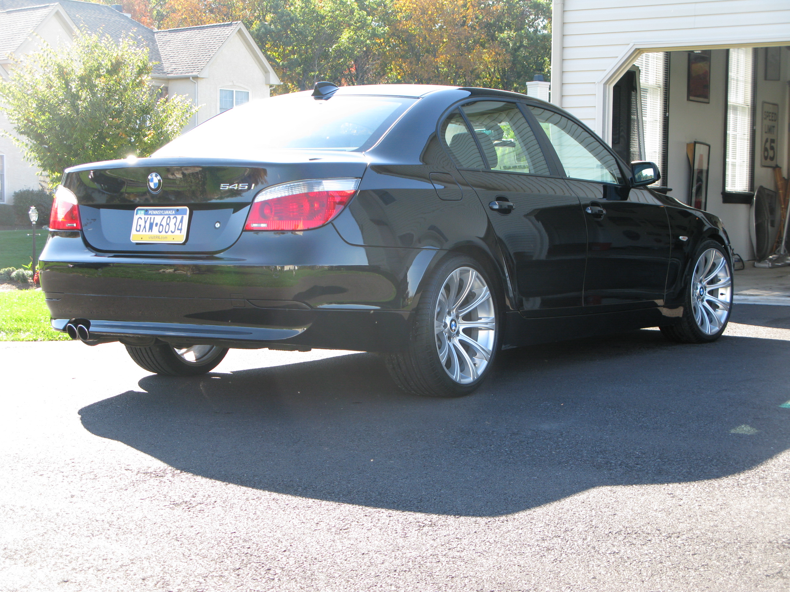

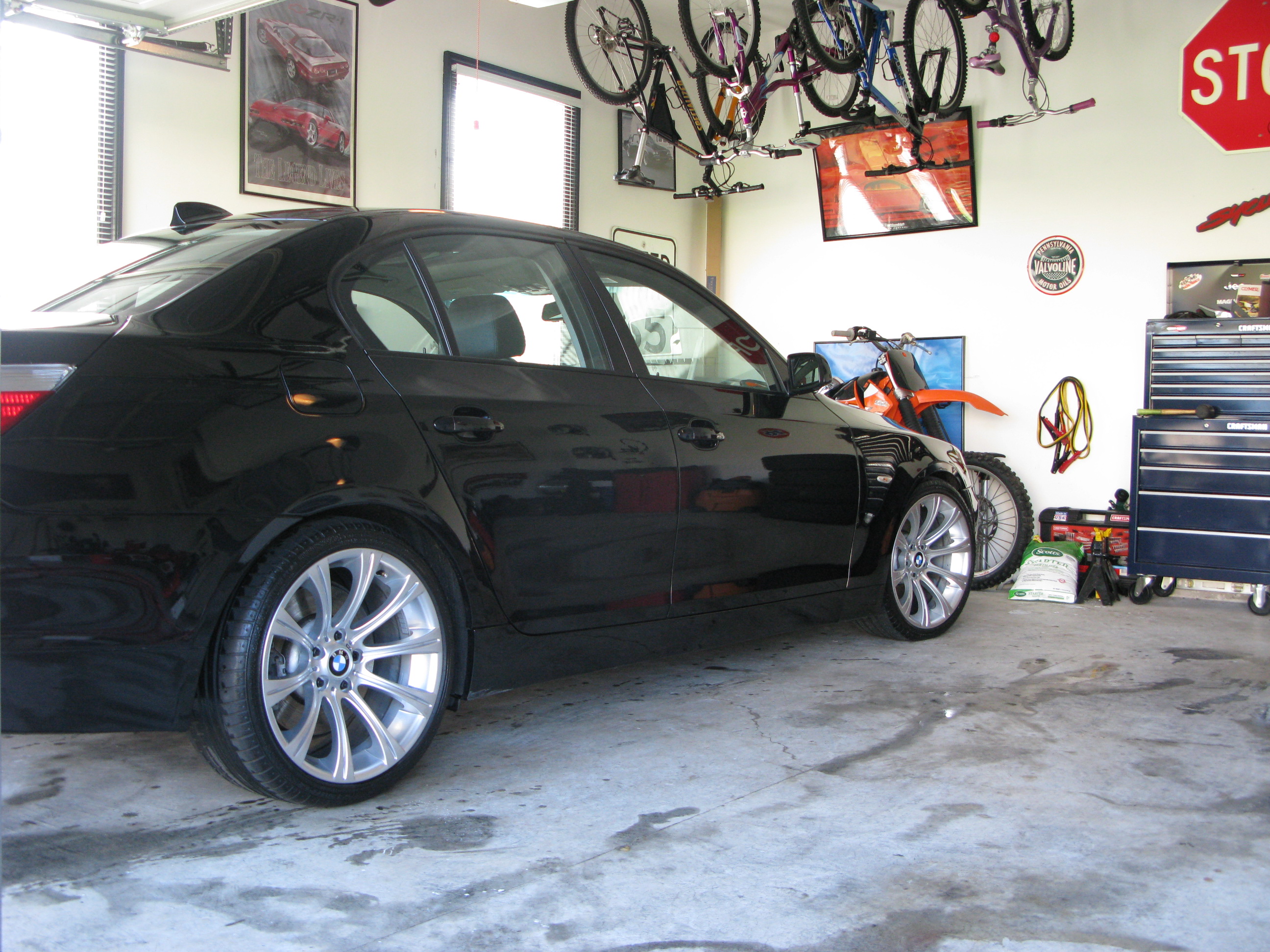

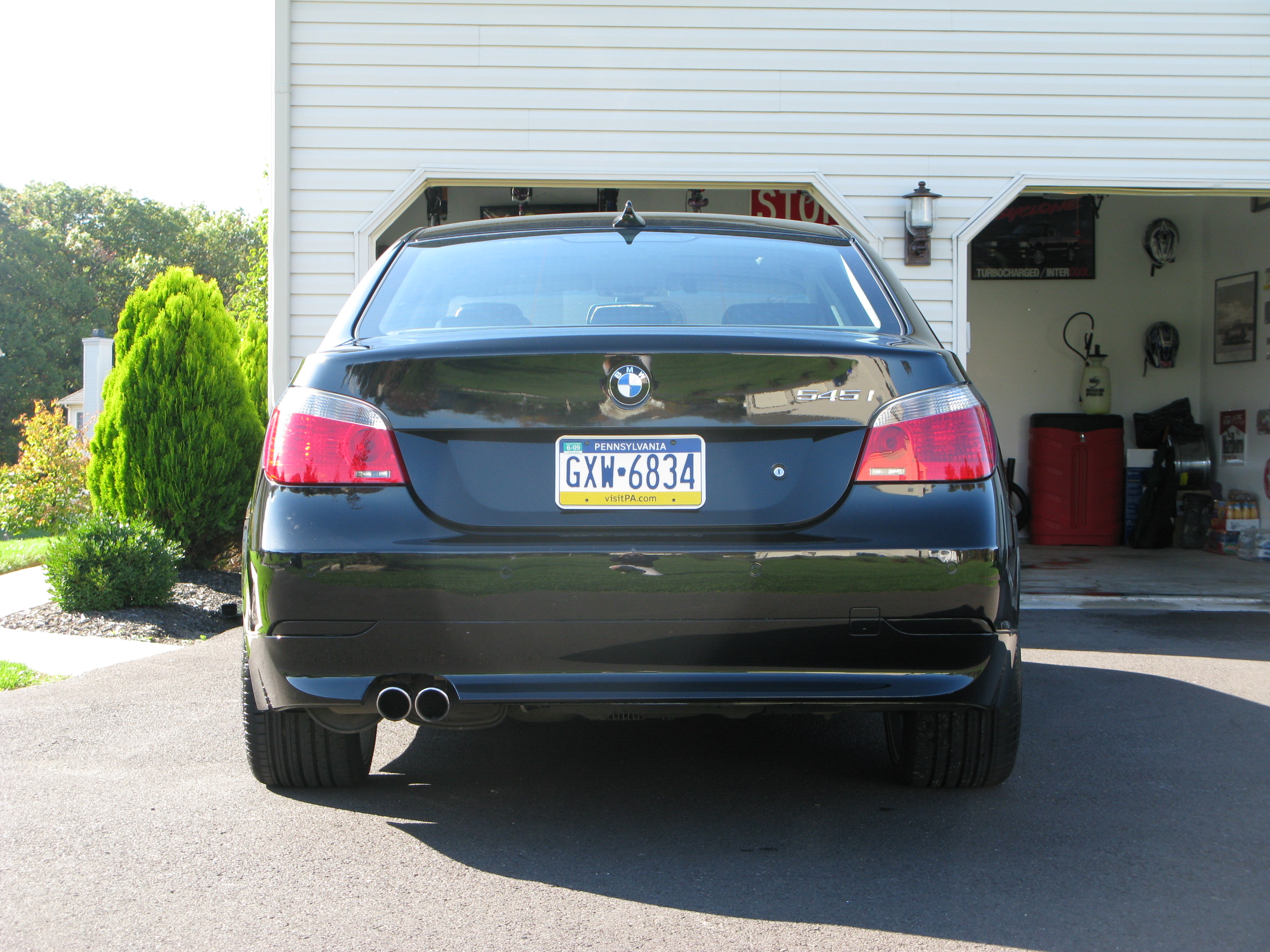

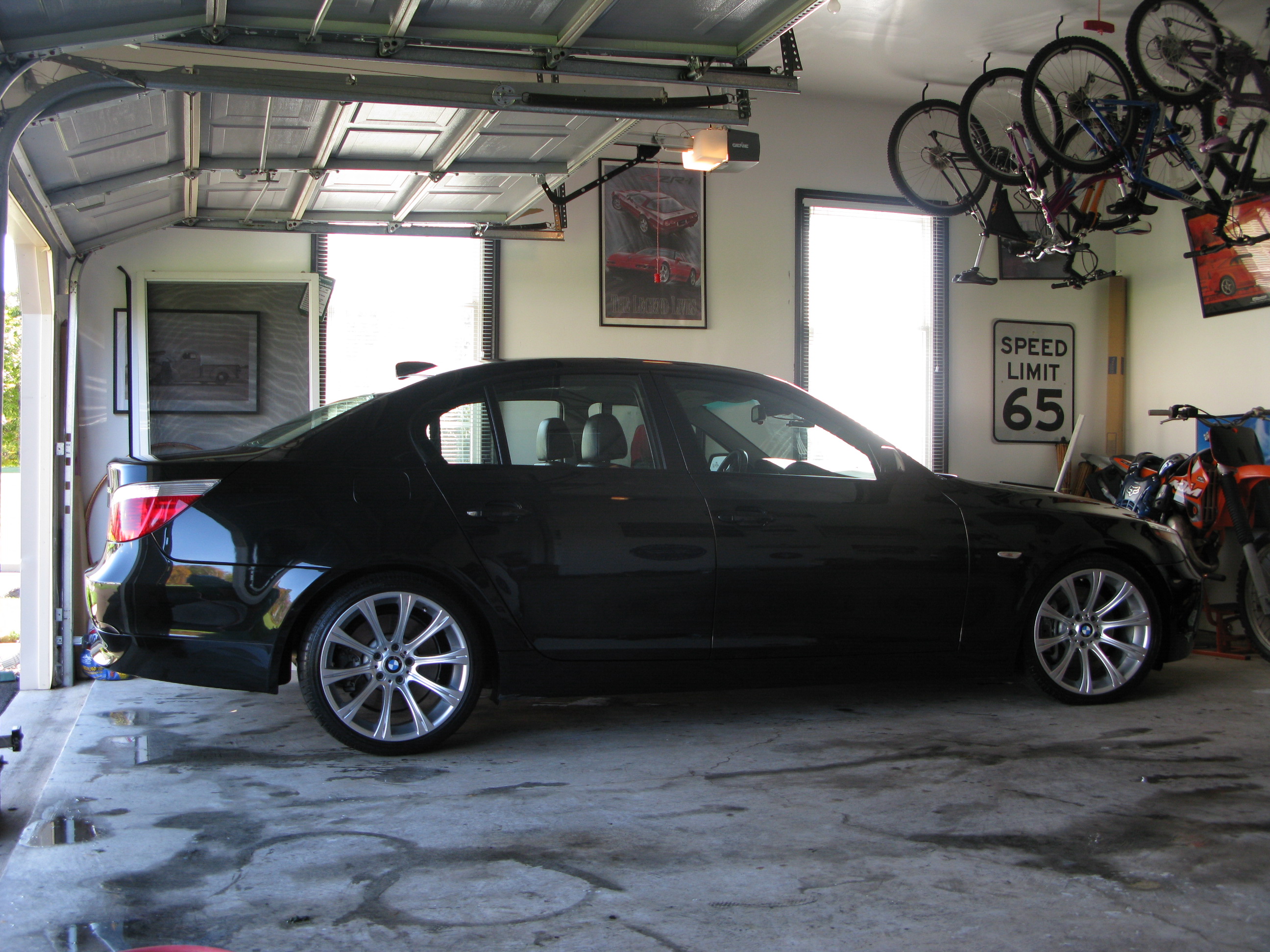

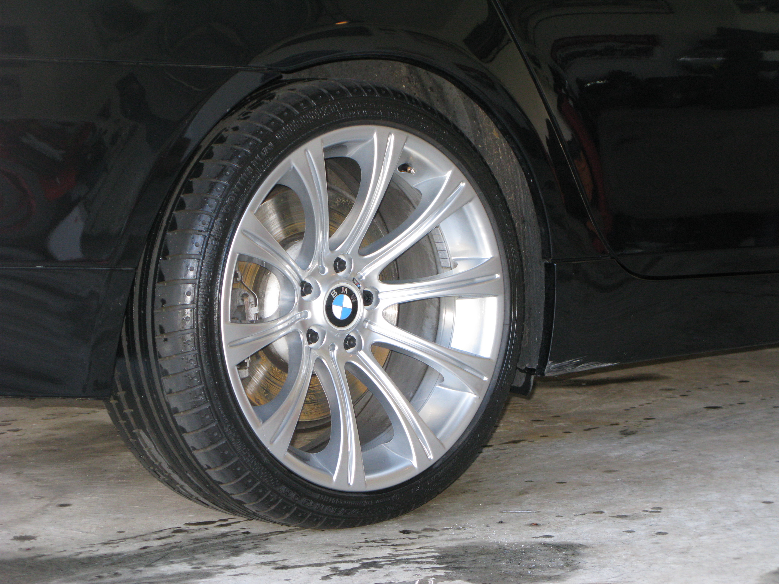

Here's my 05 545i with 275/30 & 245/35 continental tires on OEM M5 rims. 285 is ok in the back but 255 WILL rub bad...trust me!! I've got to say the oem 18's drive a bit better!
