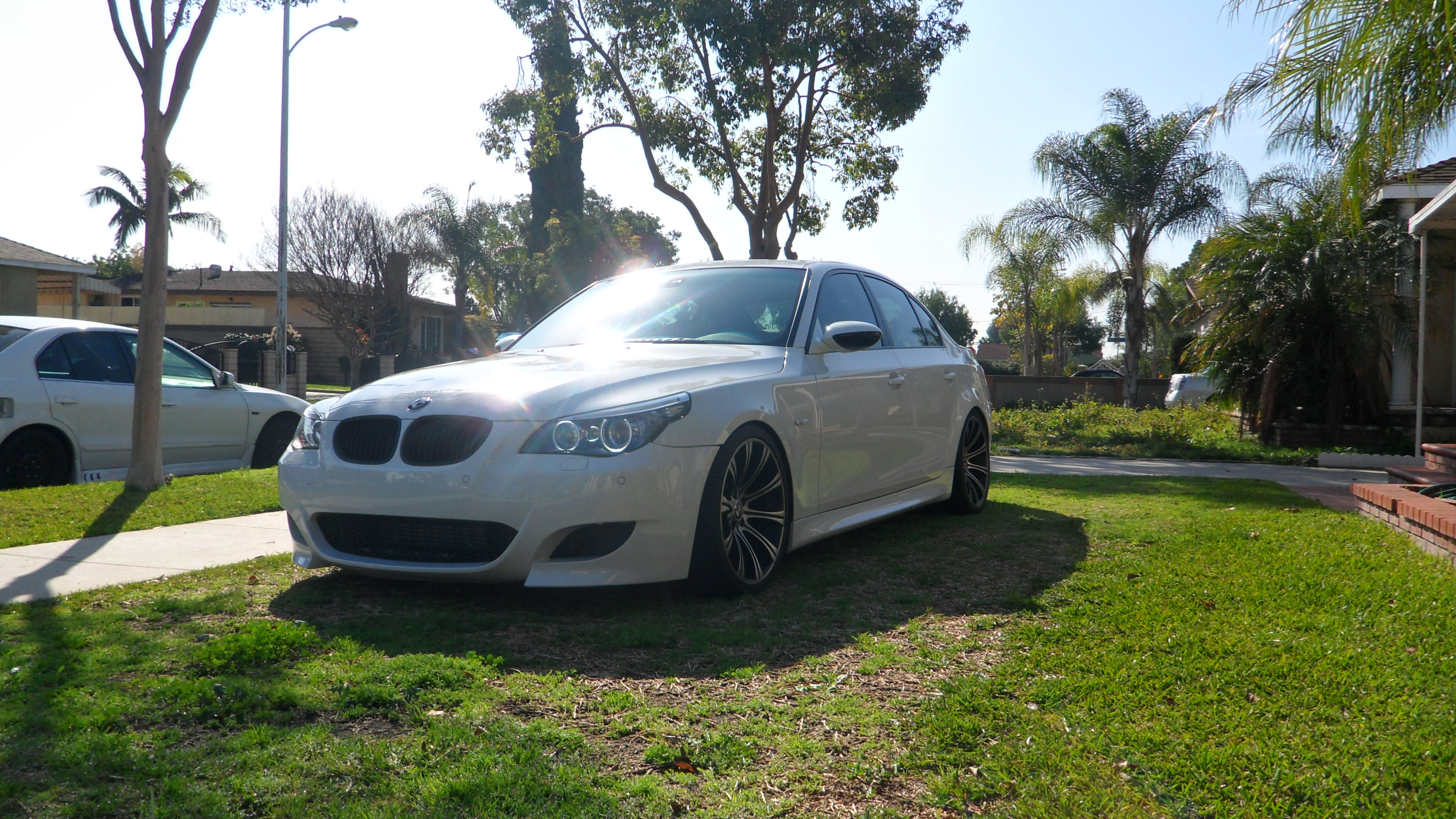

jcool10181's Avatar
Posts: 1,492
Oem M5 bumper fits with the M5 brackets! Checkout my ride. Fitment is close but not totally flush since the M5 fender is 10mm wider.
+1
I have the oem m5 front bumper as well they are a 95% fit if your bodyshop can adjust it right.
