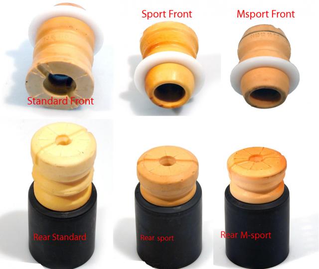

I recommend Bilstein SP over Koni for the following reasons:
1. Koni's rear strut adjustment is not external. You pretty much has to make up your mind on how stiff you want the rear strut to be then install. Once it's installed. You can not adjust w/o removing the whole setup.
2. Bilstein SP front strut is inverted design.
3. Bilstein SP comes w/ built in shorter bump stop so you don't have to trim anything.
If you are replacing spring/strut. I recommend replacing front top mount at the same time because mine has some cracks around 48K miles.
If you end up w/ Konis, I'd get Msport bump stop. (probably European market OE part)

Originally Posted by Howitzer
where do you buy these stops?
For Msport bump stop, I'd contact gromani@bmwofnewport.com to see if he can get you these parts.
I don't know whether BMW sold Msport suspension in the US so it maybe European market only.
http://www.realoem.com/bmw/showparts...61&hg=31&fg=10
http://www.realoem.com/bmw/showparts...70&hg=33&fg=45
Looks like there are 3 bumpstops part #s.
For the M Sport one, part is 31336764086 front and 33537905317 rear
