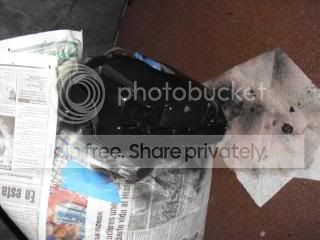

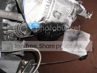

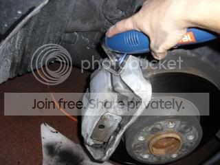

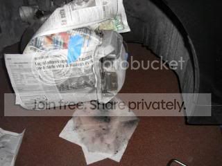

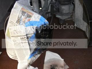

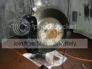

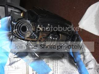

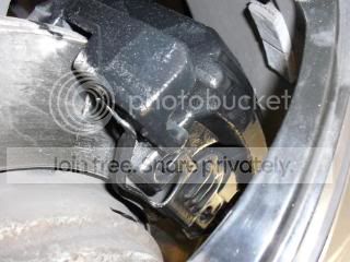

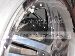

WELL HERE IT IS GUYS THE PICTURES I PROMISED. ENJOY. TOOK ME 2 DAYS!! TIRING JOB BUT AT THE END IT PAID OFF!!
REAR CALIPER
REAR CALIPER ALMOST FINISHED
REAR CALIPER
REAR CALIPER COMPLETED (I KNOW THERES A CORNER MESSED UP, BUT I FIXED IT AFTERWARDS)
FRONT CALIPER BEFORE PAINT WAS APPLIED
FRONT CALIPER FINISHED
SANDING PROCEDURE (ABOUT 20 MINUTES OF SANDING PER CALIPER)
FRONT CALIPER CLOSE-UP
REAR CALIPER FINISHED 2
