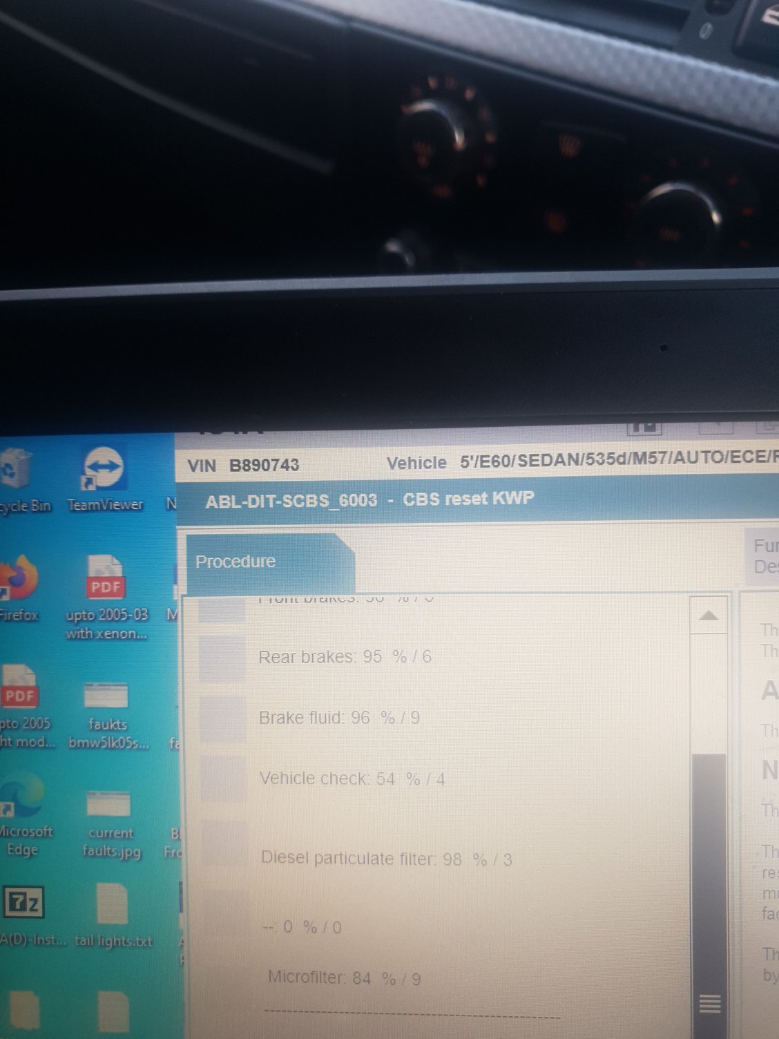

Post photo of your cbs reset meniu in ista.

I think you are right. We need to find where in coding we can disable these 2. Try to read fsw_psw. ,From Kombi first.

[QUOTE=Bmwpower530;1617407]
It was in the KOMBI, disabled both dpf and Microfilter.. by switching from display to hide.
Thank you ver@Bmwpower530
Now those ghost entries are disappeared. But why does the CIC not pick up the engine oil level? Is that normal?
