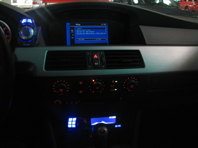

You guys make it seem like I want to remove the iDrive, this is what I want to do, but I was thinking of a better aftermarket unit, might even possibly go the same route....
That looks sweet!

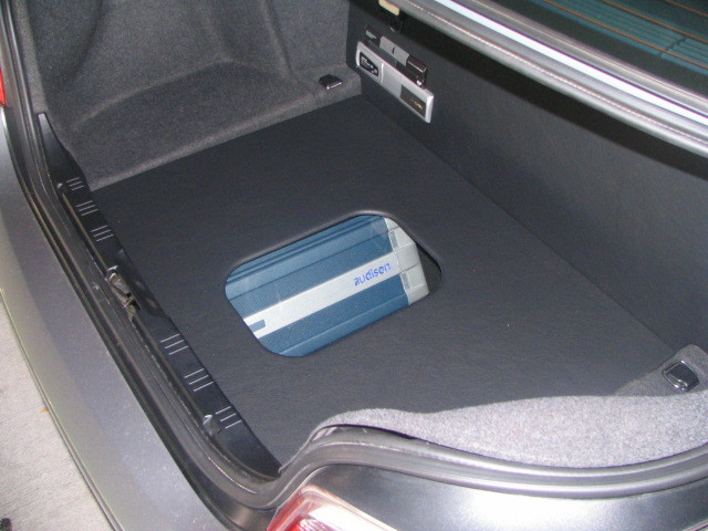

I dont have an aftermarket unit, what you see down there is the controller for the alpine pxa-h701 processor. The alpine vehiclehub was a PITA to install, you will have to remove both the passenger seats and rear seats to run the cables. You will also need a nav-tv interface($350) to see video thru the idrive screen. A lot have changed since the alpine vehiclehub and cleansweep came out. Theres better options out there.
Heres some more pics of of the install.
