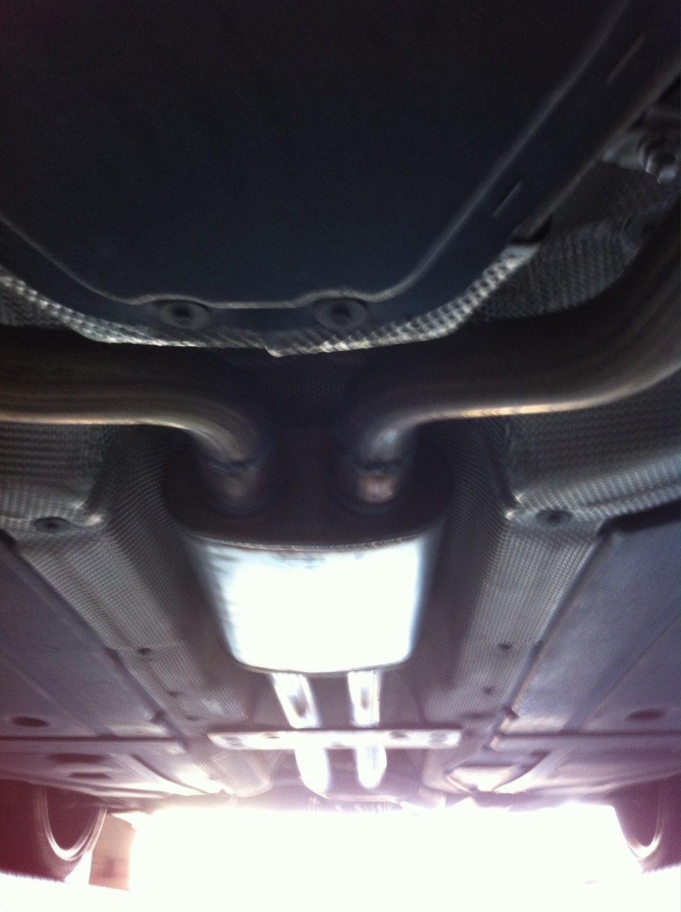

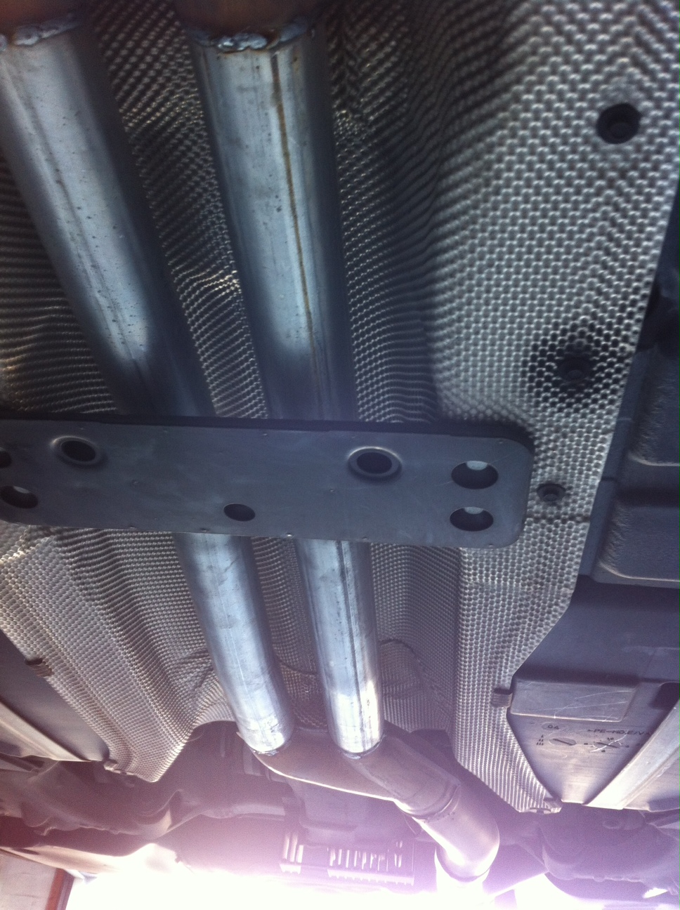

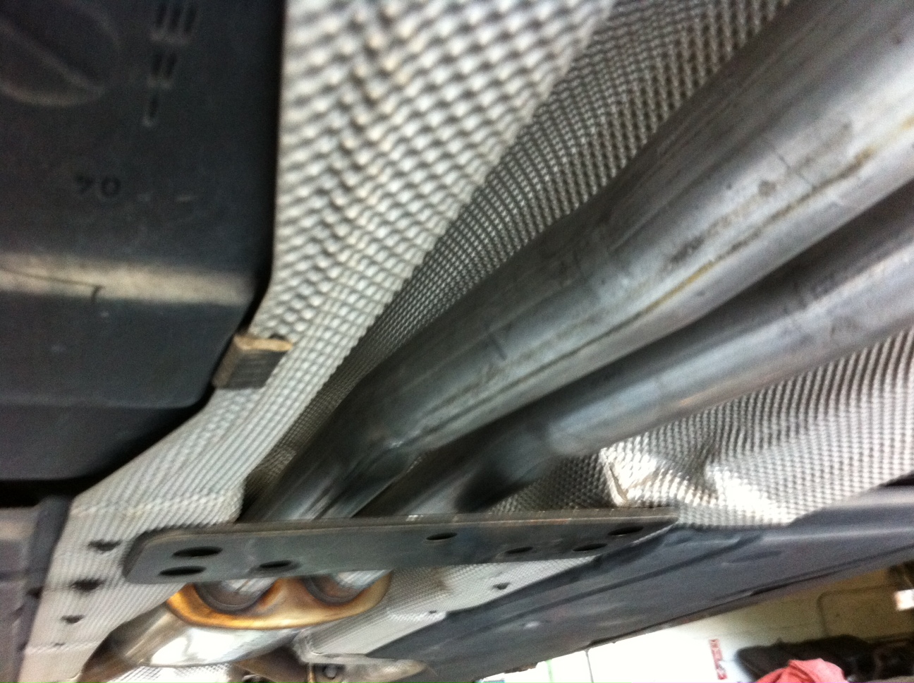

that's more or less what I did to my car for christmas, except I have an eisenmann race exhaust at the rear. I replaced the front resonators with a magnaflow resonated x-pipe and got rid of the rear resonators. sounds great, no droning, although if I had it to do over again i'd either put a longer magnaflow up front OR leave the front resonators and just replace the rear one with the x-pipe, It's not that it's too loud, it just lost some of the refinement. I did it in two stages, first I got the x-pipe and then a week later I removed the rear resonators. it had a nice tone to it with the rear resonator, infiniti like, but a bit too quiet. that's when i decided to ditch the rear resonator. yes, it's louder, but a bit less refined.
I do like it though. Note, the eisenmann race exhaust is still VERY quiet- don't try this at home with an RPI or a B&B, as results WILL differ.
[edit: dual pipes are roughly 2.25", single out back is 2.67 give or take, I usually use a 2.5 but i didn't have to on this car since i kept the stock y-pipe and the eisenmann already has the metric piping]
here are some pics of the work.
