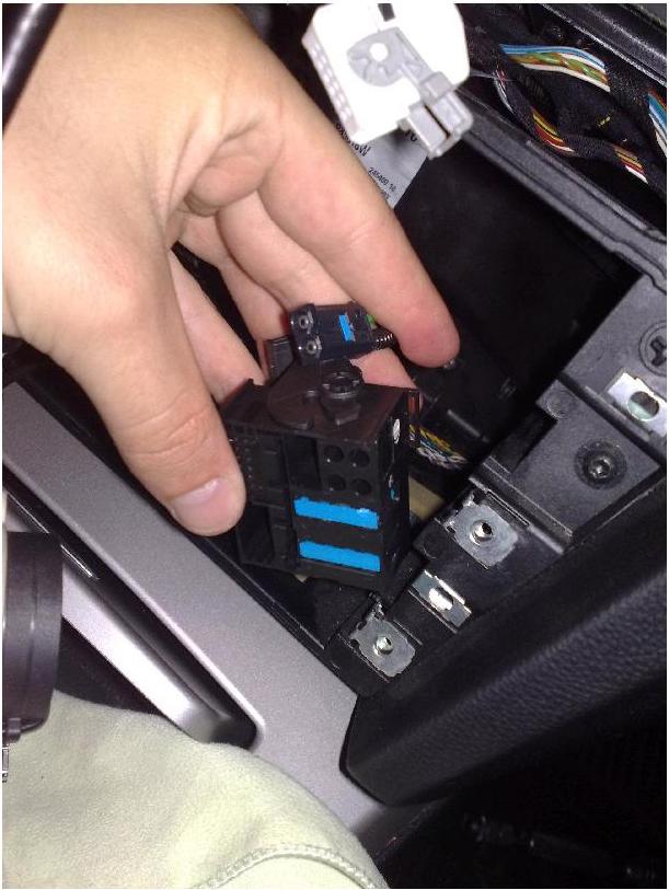

I installed the Xcarlink multimedia interface for my 2006 525i (no nav or aux input but I do have an iPod interface) yesterday and I have lost my Bluetooth capabilities and IPod interface. The install went smooth and I am able to watch video on my idrive screen. All the features work as they should on the multimedia and idrive except for the Bluetooth not allowing me to enable and the iPod interface being grayed out (not allowing me to select CD with the iPod being plugged in) in my idrive. I triple checked all connections, could it be possible that I got a bad harness? Let me know what you guys think. I hope I do not need coding, it seems like idrive does not recognize the Bluetooth and the interface anymore.

Check your MOST connection(s) ... it seems to be fiber link problem.

I think I missed this step...

Thanks BlaSTiWi that did the trick...everything is working now!
