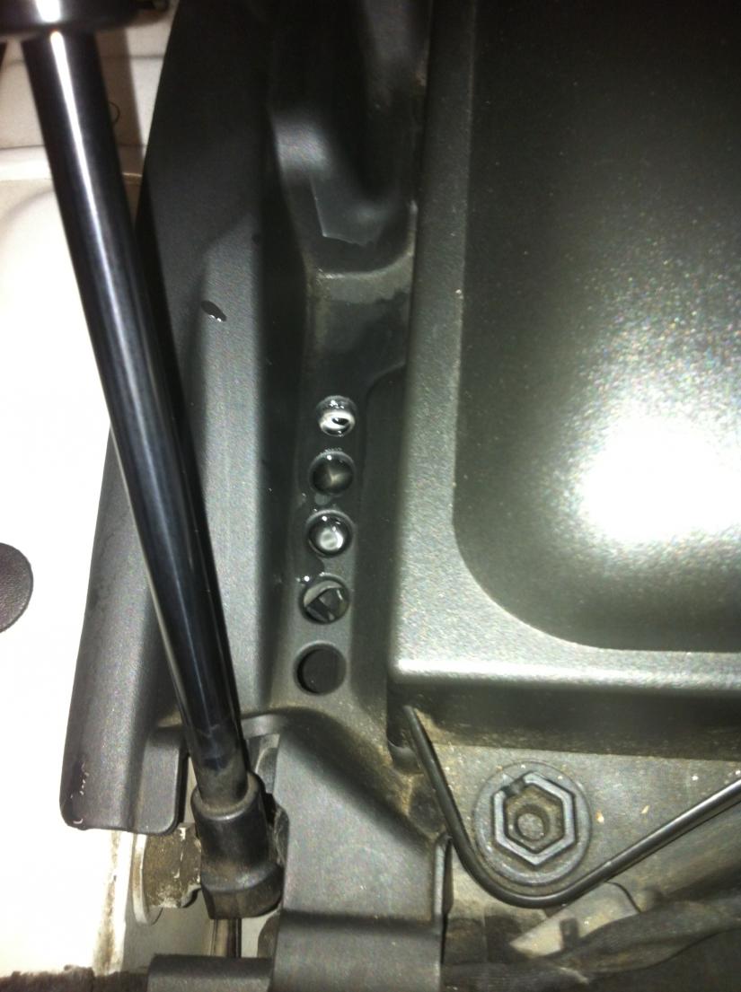

There is six total drains . 3 per side . 2 for the cabin filter drains . Two front and two rear sunroof drains .
Sounds like your front cabin filter drains are frozen . But appears that they are working due to the puddle under the rear of the front tire , That is where the water exits from behind the front wheel from inside the well cover drain exit .
If you look under the hood by lower shock linkage .. You will see a plastic cover with holes in a line .. Pour some hot water in there ,, it should melt the ice inside the drain tube and exit just behind the front wheel ..

nice thank you for the insight I pulled her in the garage at about 1:30pm today when I get home ill check out what you advised , thank you again

Leak from windshield washer pump leakage results in water IN FORNT OF THE front left wheel.
Drains referenced in this thread drain the water BEHIND the front wheels.
