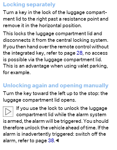

luigi524td's Avatar
Posts: 5,972
Thumbs up
Originally Posted by zagato' post='782525' date='Feb 1 2009, 03:11 PM
Yup, all 4 doors are unlocked... nothing, worked fine, but today it stopped working I'll go to my local dealer sometime next week.
These instructions are in the owner's manual - you may have set it the in the locking position ? ?

Rudy's Avatar
Posts: 17,310
From: Pittsburgh, PA USA
My Ride: G30 M550i
Model Year: 2018
As others have said, it may be some confusion on how the valet lock works. Take a look here:
http://forums.e60.net/index.php?showtopic=18291
If that's no help, then read on...
There's a little microswitch underneath the rubber "boot" (just above the license plate) that you press to open the trunk. Sometimes that switch can fail and other times, the rubber boot can get dislodged and prevent the switch from operating properly.
Before going to the dealer, check the boot and/or see if you can hear the microswitch closing (a slight clicking sound can be heard) when you press on the rubber boot.
