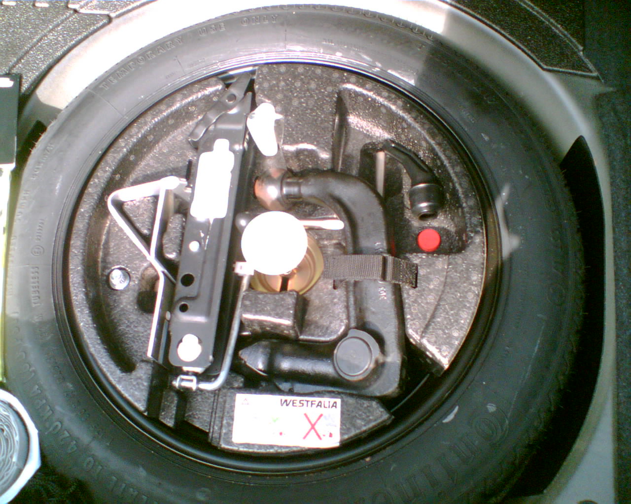

As regards the spare, there is a BMW OEM spare tyre/jack kit that you can get. Here in the Netherlands, it is my understanding that we have to have a spare in the back, RFT or not, and my car came with the kit. It sits under the trunk liner, and certainly seems to sit there flush and comfortably. If memory serves me right, the tyre is a 135/60 R17. Pic attached.

Heres my wheel and bits
