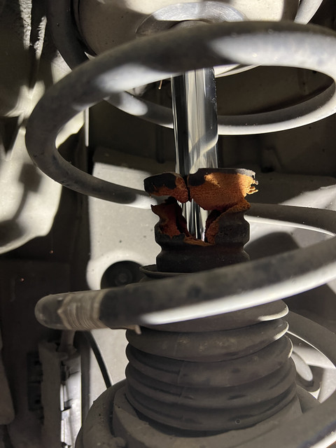

However I have found some play on the wishbone. On the two sides it's about the same so I took a video so someone could tell me if that's normal. I don't know if it's me just compressing the rubber with my hand or what. Here is the
Also i noticed that the damper in the front suspension is completely worn out
And some scratch on the rubber of the control arm

Here we go for some pics :
I couldn't find anything wrong with the tie rods.
Time is as much a killer for rubber parts than mileage i suppose.

You certainly can refresh those components, I hope it helps. I refreshed all my dampers, front tension struts, strut mounts, etc. and can't say I noticed any improvements (not that I really had problems to begin with, just knew they were old). My old shocks didn't really pop back out any more after being compressed by hand.
I replaced all the bushings and or control arms on my E61, and they were probably better than those of yours. ;-) That front control / compliance arm is the suspect in a whole lot of front end issues, and could easily explain your issues. I like just shotgunning the whole "system" so I only need to get one alignment done (since if one part is toast, the others are probably following close behind). It's also nice to have "like new" feel through the suspension again.
