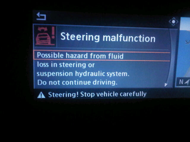

Hoping its not a huge repair
Taking it in Friday.
Did a power steering flush last November and everything checked out great.
Maybe active roll or shock problem?
Only 37k miles - what you guys think it is?
jack it up and inspect the front ARS unit. Mine was leaking fluid awhile back and I had a similar message, forgot exactly what it said hough but I remember the pic of the tilted car.

Spot on my friend - it is looow!
Any idea how that could happen - think the dealership didn't fill it back up to the proper level when they flushed it?
CHF 11S - can I get this at any auto parts store - or should I get it from BMW?

you can get it from bmw, and many other german dealers....audi, porsche, vw, mercedes, etc or try napa, and sometimes oreillys.

Problem solved! Just filled it up with new fluid I just purchased form the dealer - error message gone.
But still really shocked how low it was.
Now, I looked around the seal and it appears it might have overflowed/leaked?
How can this be as I had a power steering flush last Nov and the invoice said all seals etc checked out OK?
If I have to replace the seal around the top of the reservoir is this a big deal?
