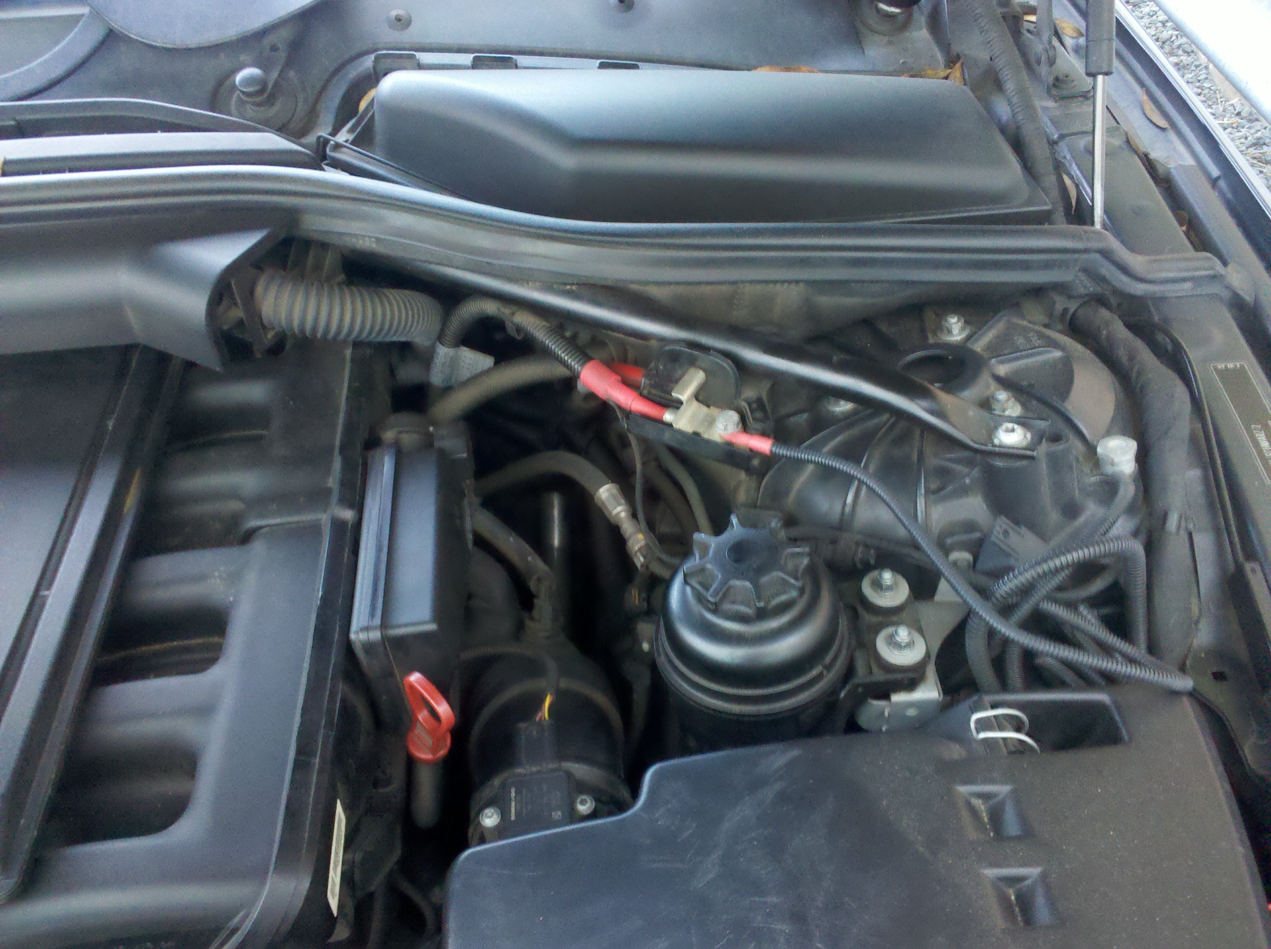

Okay, found out the problem--notthing major but kind of unexpected off-the wall.
Starter is fine
Battery is great
Looking at the picture, the big red wire cable attach under the metal plate of the positive post. I guess there were dirt and some corrosion underneath the metal plate. The red cable wire goes to the starter! Apparently when I jump started the car, the jumper cable made better contact to overcome the resistance (dirt & corrosion) and power the starter.
For anybody looking to jump-start, the negative post is to the right of the positive. The "negative chasis bolt" is that big hexagon nut.
