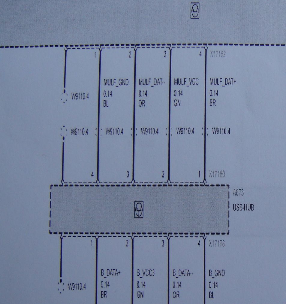

Consulting ETK and WDS, it became clear that the bluetooth telephone module also takes care of the USB interface. I opened the telephone module, called MULF2, and reverse engineered it as far as possible.
My E60 is pretty basic and therefore the MULF only has 3 connectors:
1) Bluetooth antenna
2) A 54 pin white connector with only 7 wires: Microphone for voice recognition & carkit, and the wires going to the phone cradle
3) A MOST connector with 2 optical fibres
If you ordered the USB option officially, you'd get an extra 4 pin connector for USB and an additional analog audio interface on your MULF2 module. These would then go to the arm rest console, with an extra USB hub. I'm not sure yet if this USB hub adds functionality or that it just buffers the differential signal.
What I did so far: I found the USB connections on the PCB, and since it seems that all components are mounted, I soldered wires to them. I mounted everything again and tried an iriver U10.

I'm 70% sure that the hardware and firmware is all in place in the MULF2. I'm not yet sure if the USB hub is needed or that BMW simply designed this in because of the cable length in an EMC sensitive car. I have limited time now to continue my "USB quest" but I'll follow up on this by trying a regular USB stick tomorrow, and if that doesn't work I'll spend some more time on it during the weekend. I'll keep you updated.
