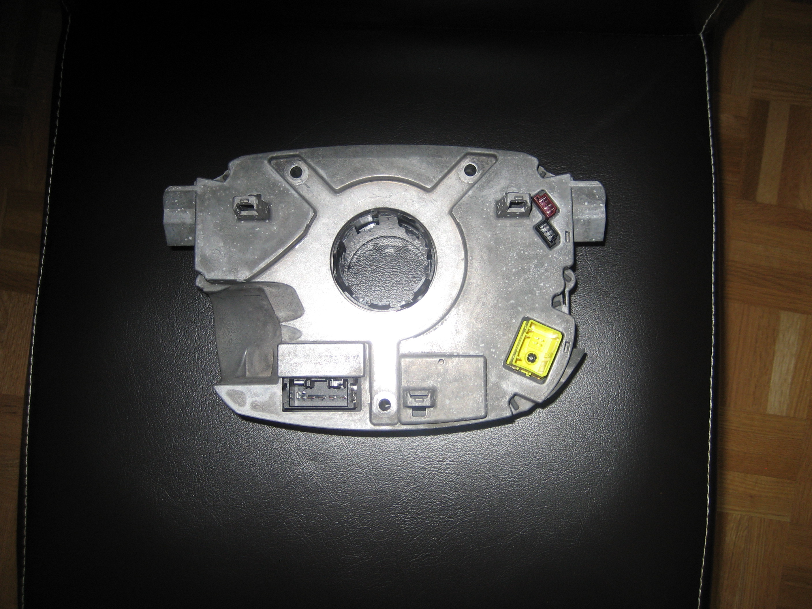

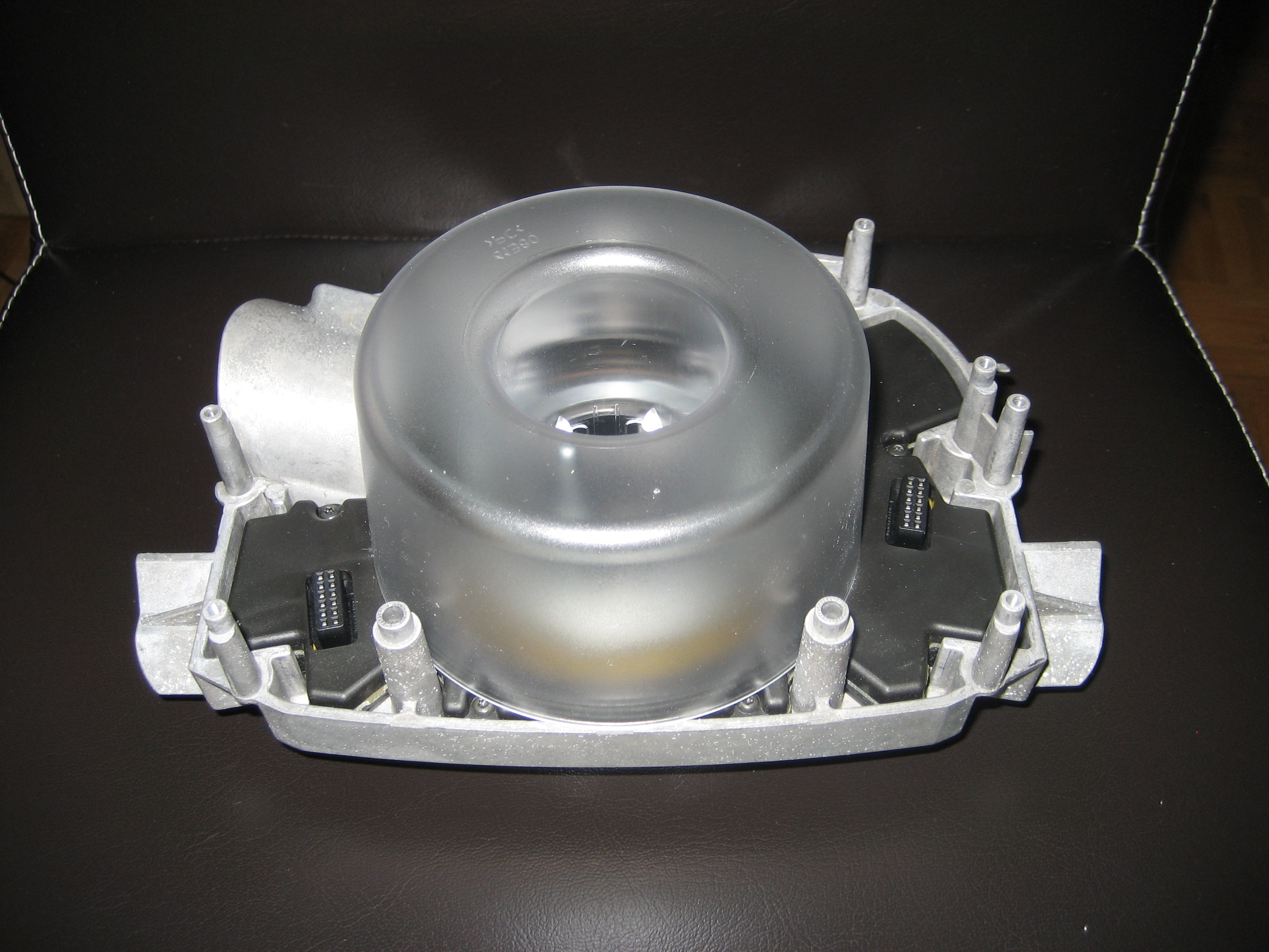

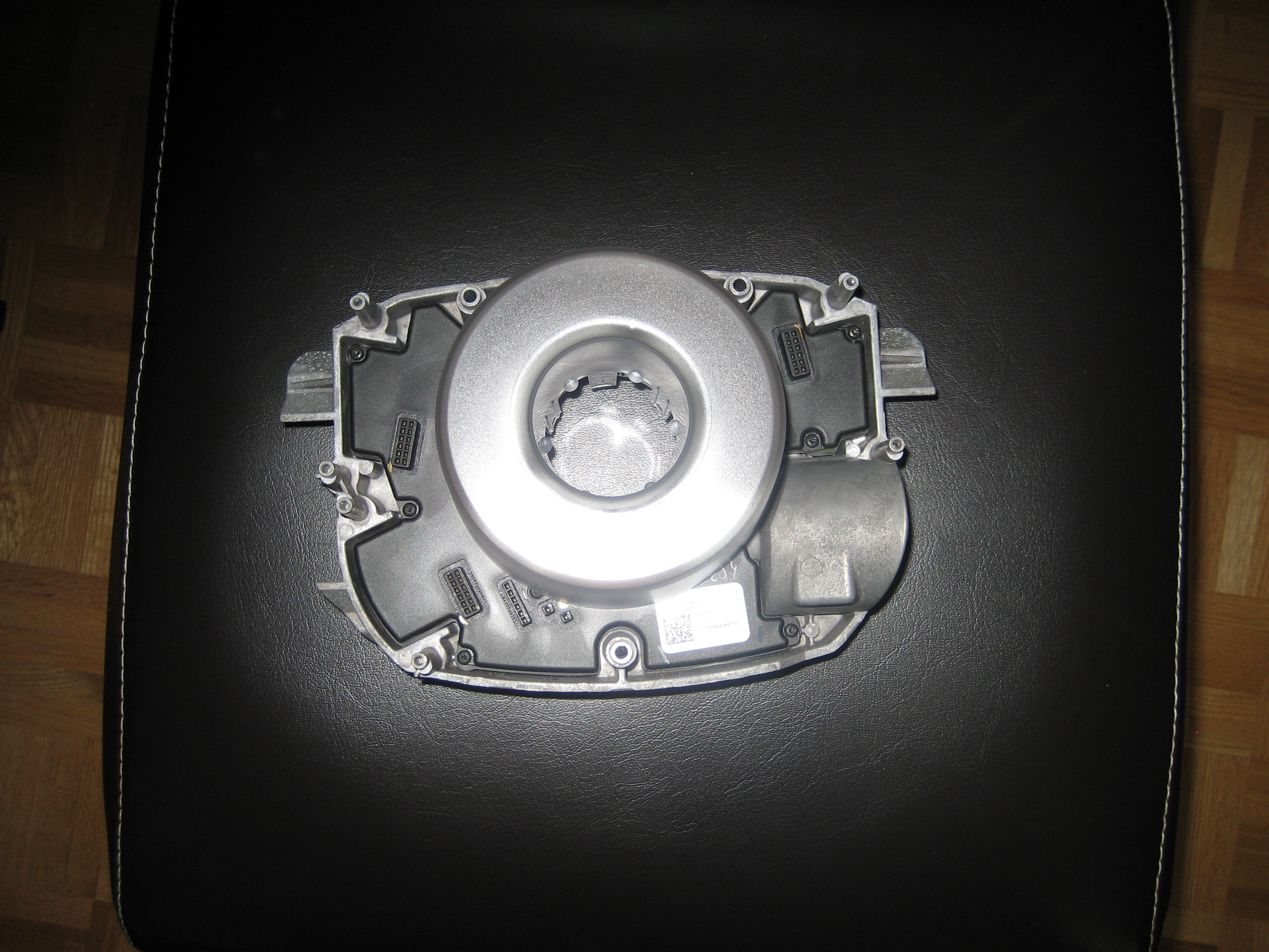

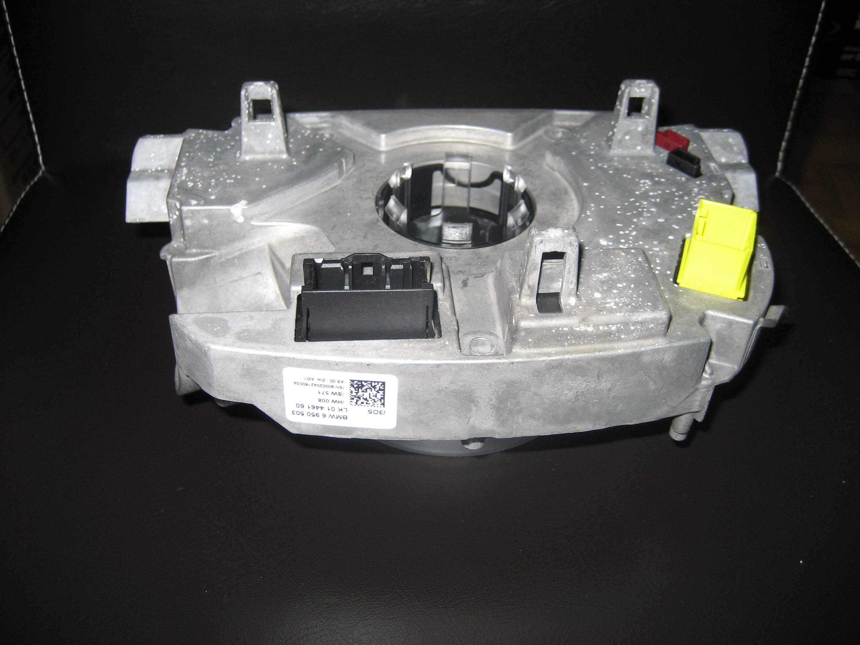

I know it's been ages since my last post but I wanted to follow up on my particular issue, in case any other e60 owners face my exact same problem... So it turned out to be my SZL module, also known as the steering column control switch unit??? ($380)... I took pics of the module to show what the part looks like in case anyone is looking for a spare one although I wouldn't recommend a used one...
it basically looks exactly as it should (a round piece that fits in between the steering wheel and the steering column and has sockets where the cruise/wipers/turn signal handles plug into) and it took about an hour to install and another hour to program (although I was charged for 4 hours)... the replacement fixed every single problem and she has worked perfectly ever since...
