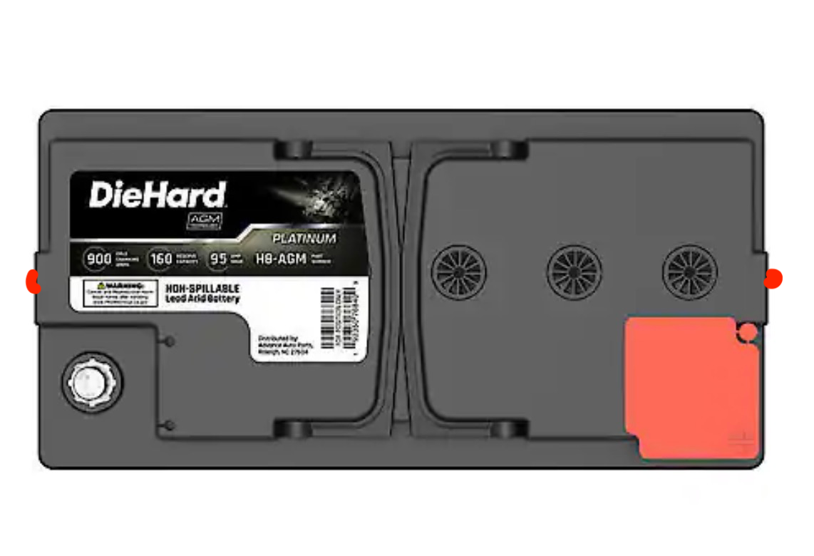

I will be replacing the battery on my 2007 530i soon and I'm looking at an H8 AGM 850CCA battery.
The replacement battery does not appear to be "vented"; there is no opening on the battery to attach the standard BMW vent line.
Is this a major issue or is it OK to use a non-vented AGM battery?
Thanks and Happy New Year!!!

Here is a battery photo from Advance Auto Parts...
Note the red plastic cover over the positive terminal.
The little round plug on the upper right corner of the plastic cover is for plugging the vent not used.
On the side, in the areas I marked in red there will be small holes that the red plug fits in. You use one side for the vent hose and plug the other side with the red plug.

Thank you, I'll look more closely for those kinds of possible openings.

The new battery was just as you described and I plugged the one end and attached the BMW nipple to the other end.
However I was surprised to see the attached hose was no more than 5 inches long and was not attached anywhere on the body of the car.
Is there a particular location on the car where the vent hose is supposed to exit. Otherwise it is simply hanging behind the battery and would be the equivalent of not having a vented line attached.
Thanks again for your thoughts.

See figure 12 for where the vent hose should attach on the car side:

Wow, another perfect depiction of the answer to my question!!! Thank you very much.
I tried fiddling with that location but couldn't get it to fit easily; I'll go back and press harder to get it connected.
Thanks again for your guidance!!

Had to pull the battery to get enough room for my hand to push the nipple into the receptacle, but got it then reinstalled battery and now all is right with my car world!
Thank you!
