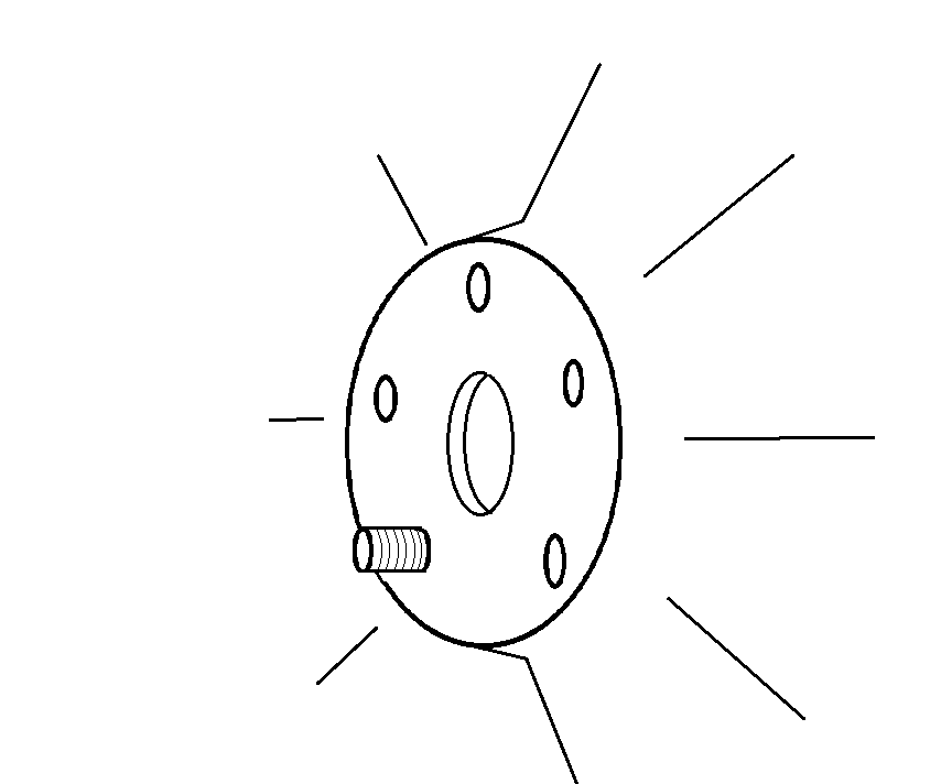

If the bolts on rear wheels are too long, they will rub the handbrake mechanism inside the wheel hub. Just a thought...

Originally Posted by amerzakaria
im using the original one .. shall i try losin it a bit
I'm not sure if all the original bolts are the same length. Just don't loosen the bolts (if I understood it right)!
Can you remove one of the rear wheels and take a picture of the bolt and the wheel so that I can see how far it goes through the wheel.
Here's a quick sketch about what I mean lol!
Q: Sound after changing to 19' rims :S !!-pultti.png
