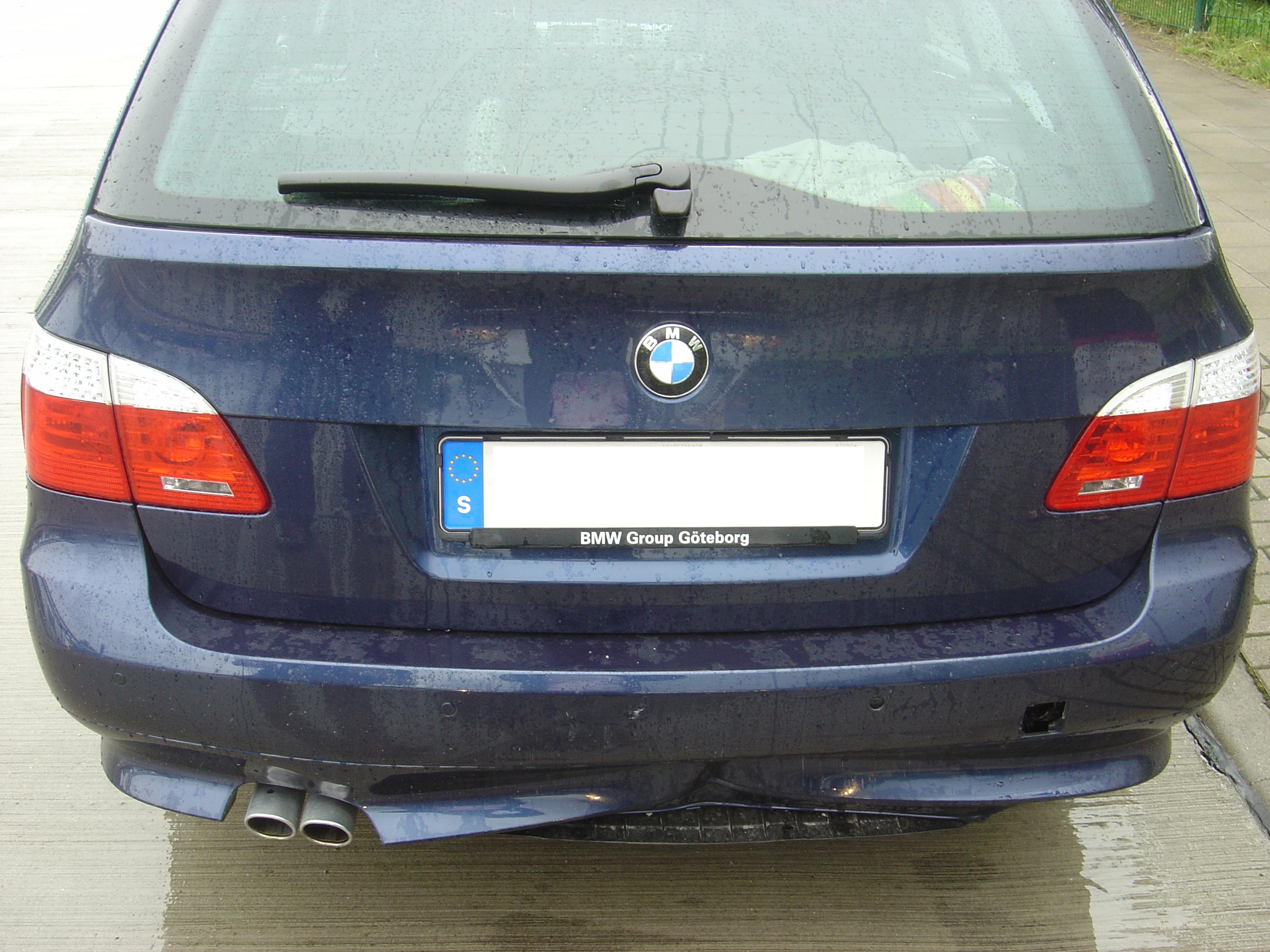

By the way, when I was driving in Germany a few weeks ago, a woman drove into the rear of my car while she was attending her baby in the rear seat. I had stopped for a red light and was quite surprised when she hit me.
