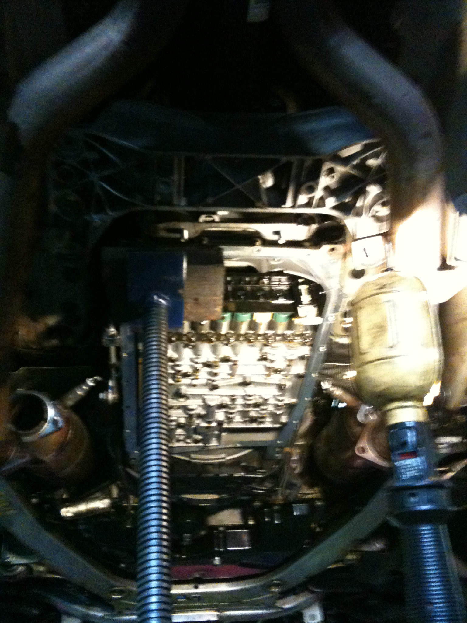

For SoCal http://www.thectsc.c...d=186&parent=50
RMEuropean Oil Pan and Filter Kit for Automatic Trans GA6HP26Z Contains: (1) Oil Pan with Filter (1) Oil Pan Gasket (1) Filter O-Ring (1) Drain Plug
For the Mechatronic Sealing Sleeve only: http://www.thectsc.c...&id=3&parent=10
Note: DIY for mechatronic sleeve is not easy because of limited space for removal and installation. Some parts need to be removed to gain access to the wire plug.
