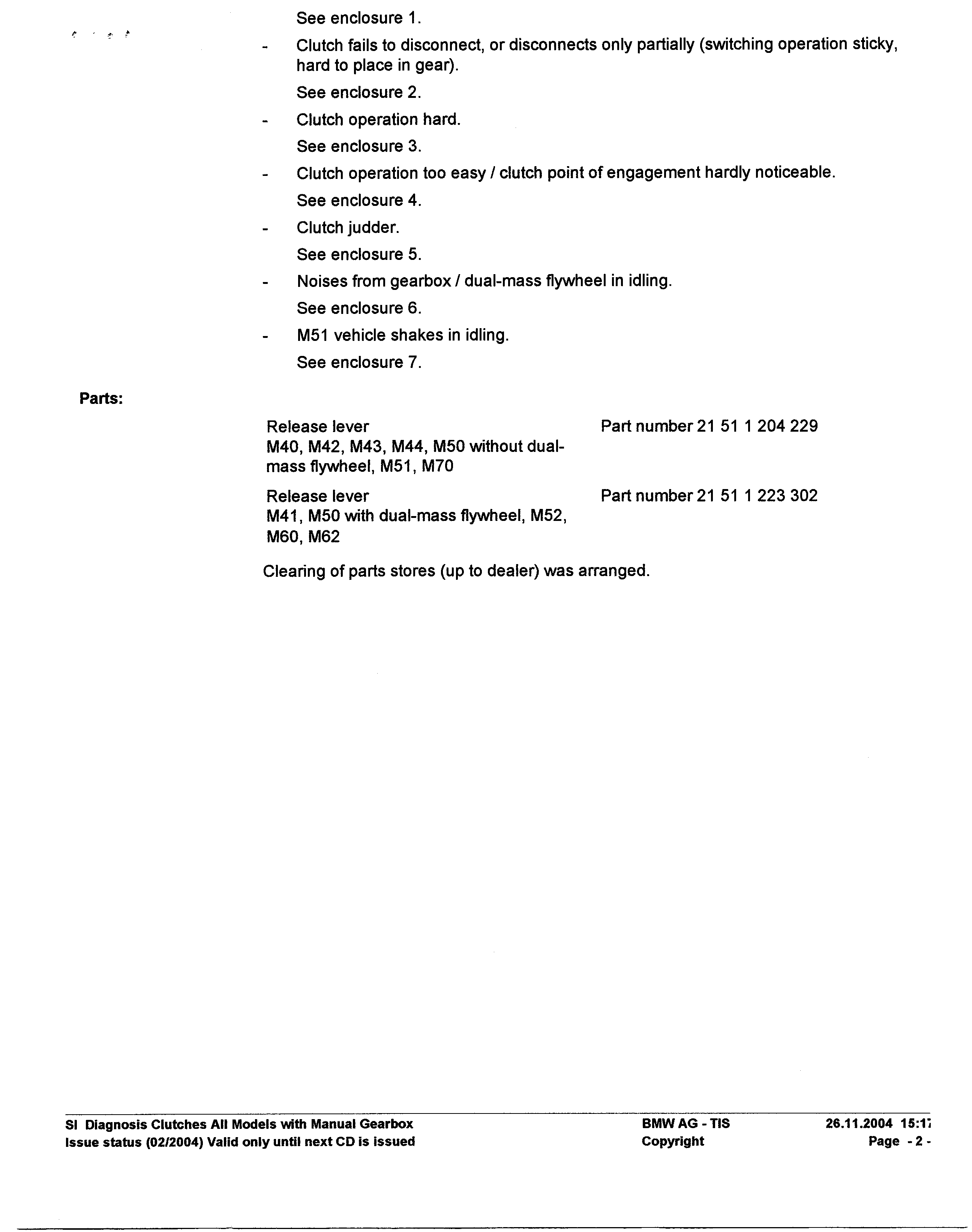

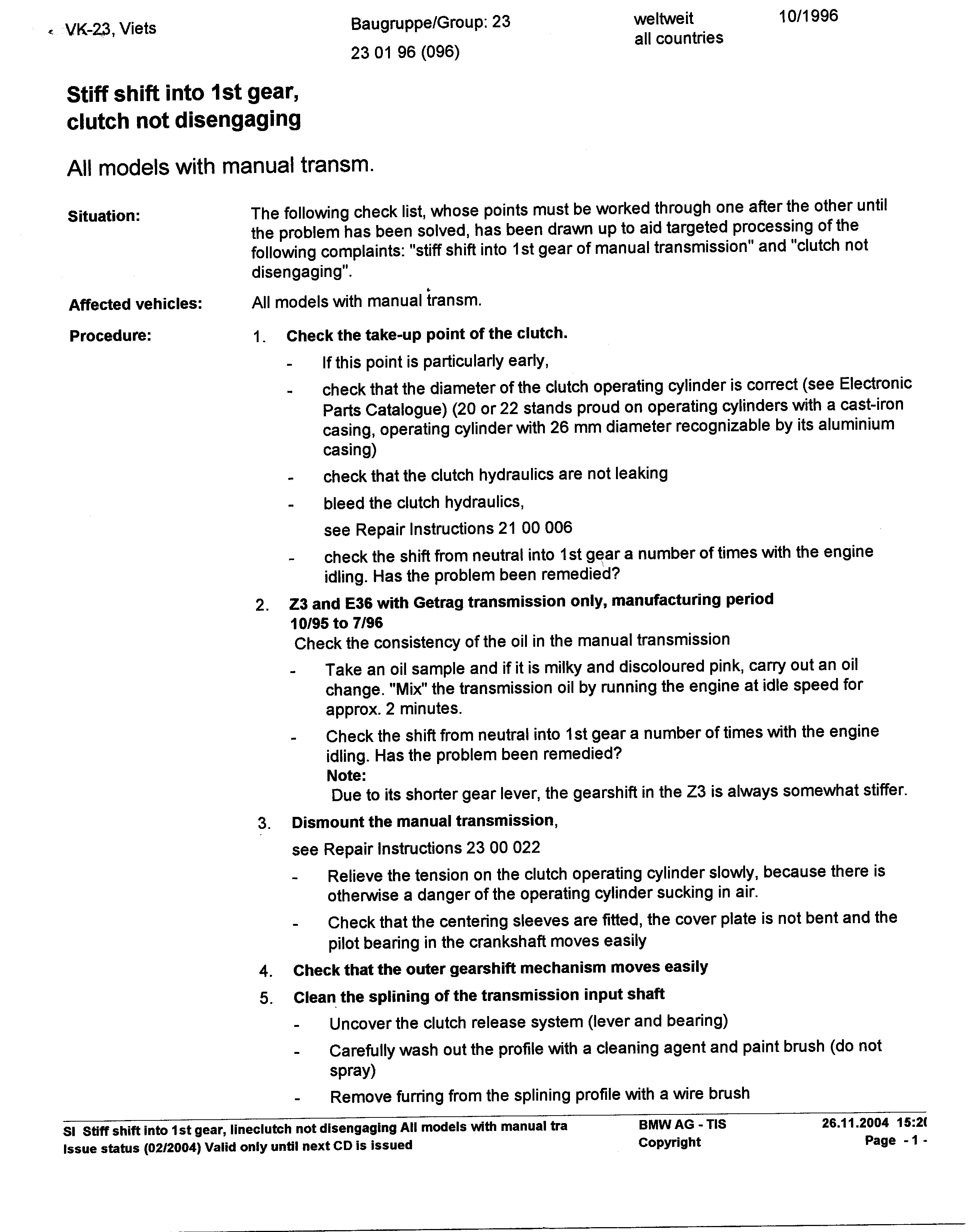

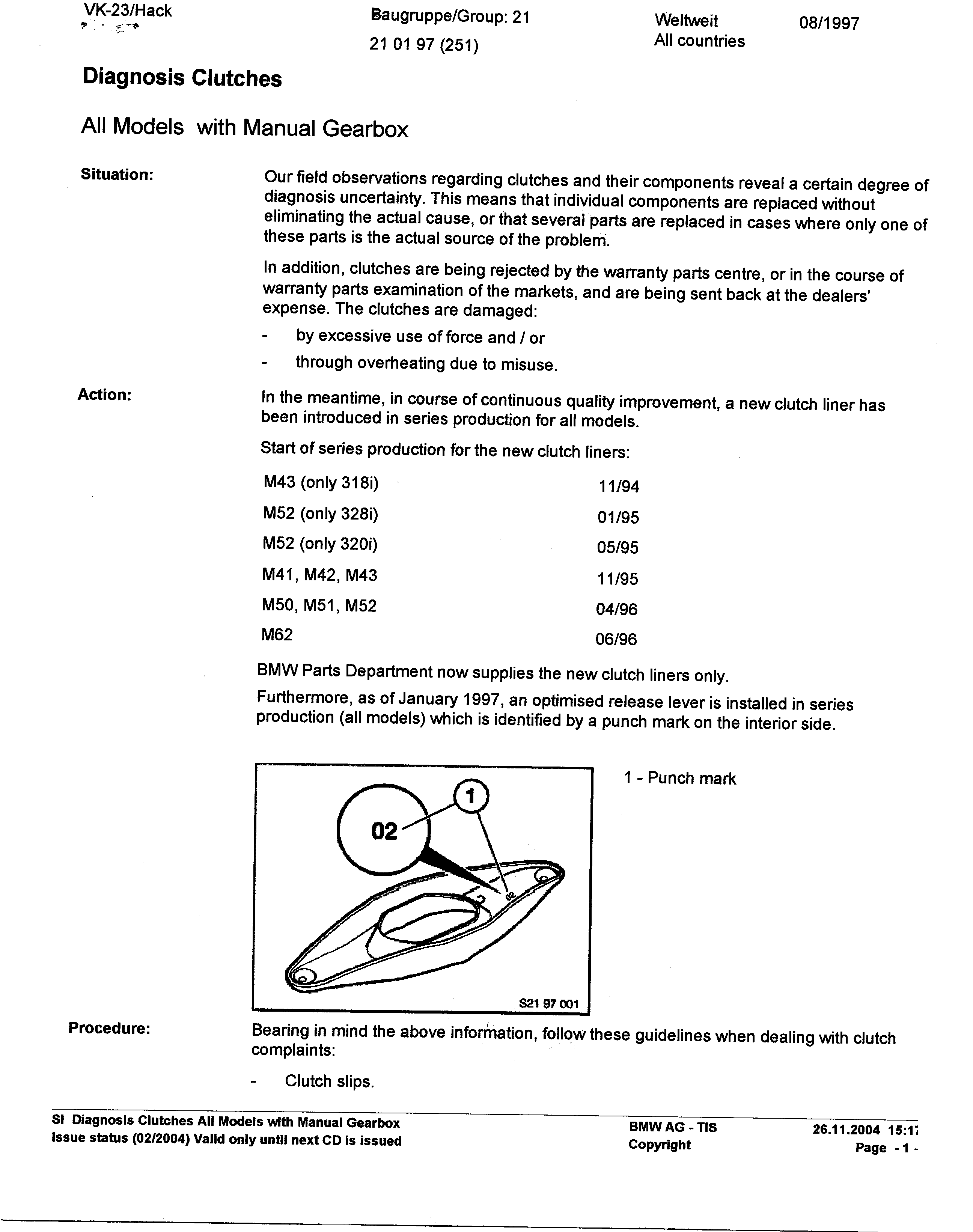

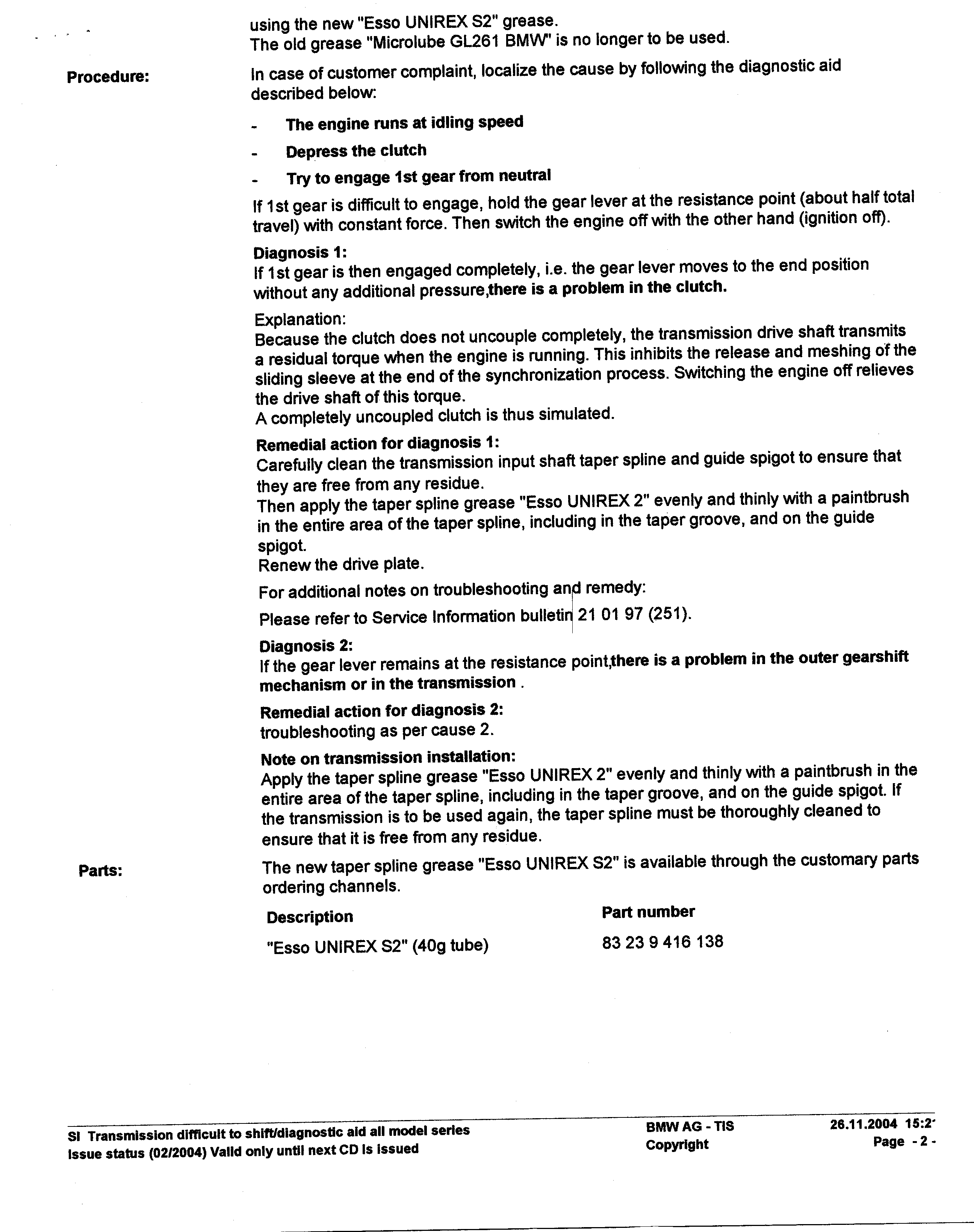

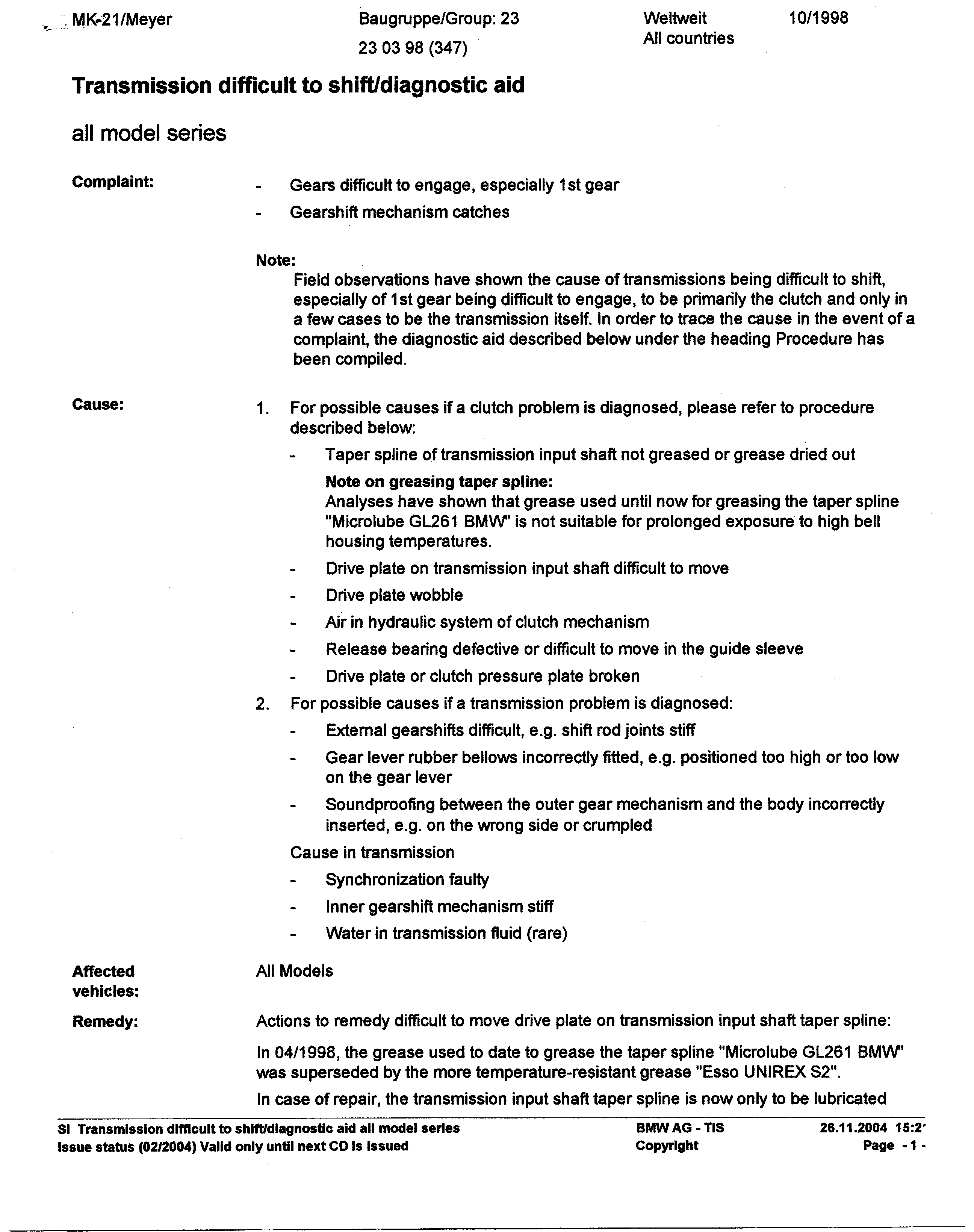

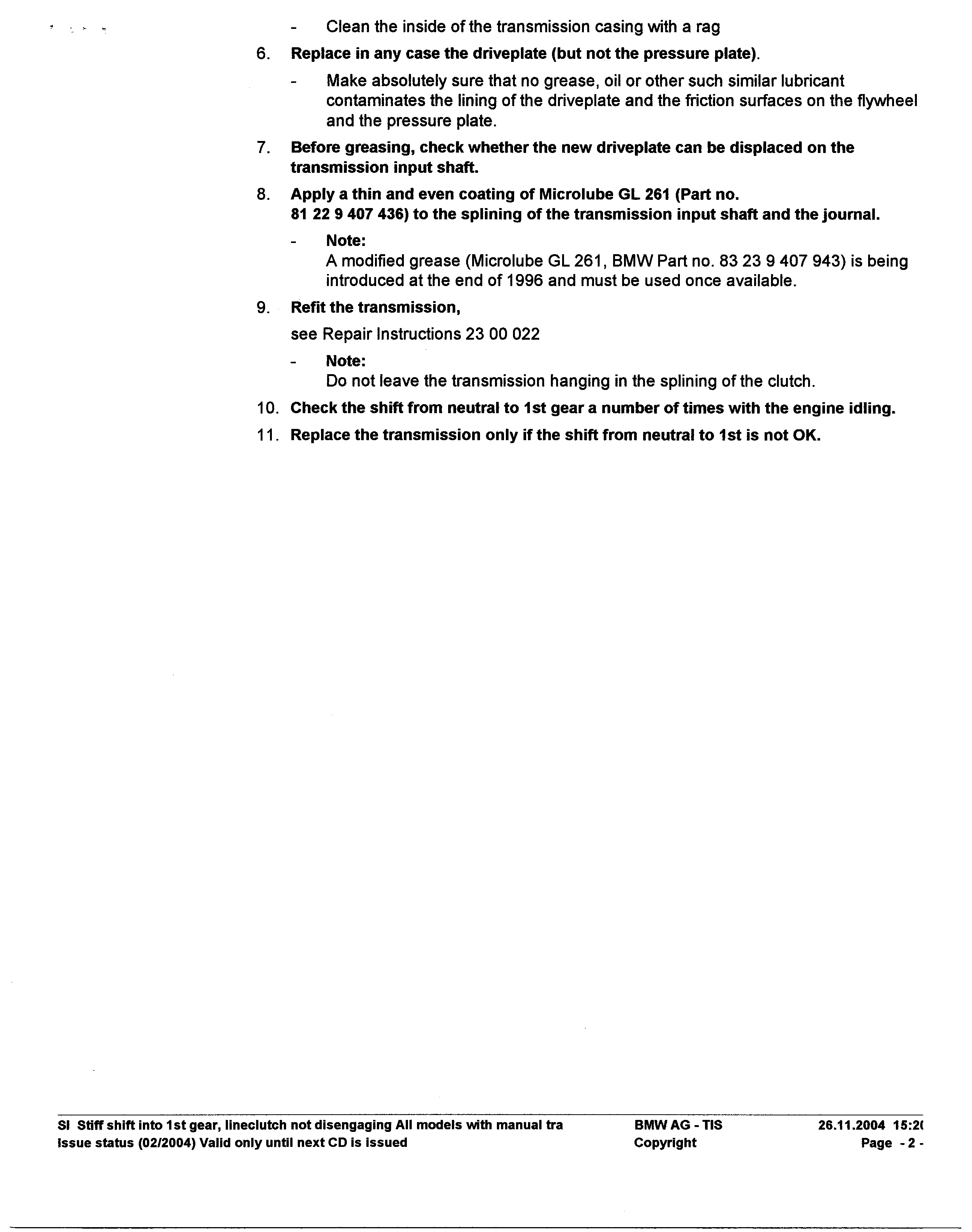

Here is the Diagnosic Bulliten, Shift Difficulty, and Stiff Shit bullitens. If anyone needs the gear slipping or juddering just tell me. They are scanned in. Sorry they are so big. Anyone have a sugestion for an easier way?
Hope this helps.

Thanks! Do you have anything more recent &/or relating to the new 6-speed in our car? These are from 1996-1998. I'm just thinking something specific to our transmission would be a little more apropos. This certainly gives me a starting point & I appreciate your help tremendously.

This is the only stuff on TIS. It says it applies to all models. This is all i could find. I think the trannys are similar. Anyone else know anything? I got it while searcing for e60 info in tis. It popped right up under (complaints-vibrations-(and a few other things)) SAme thing applies for the Mouldy Odour form air conditioner bulliten
