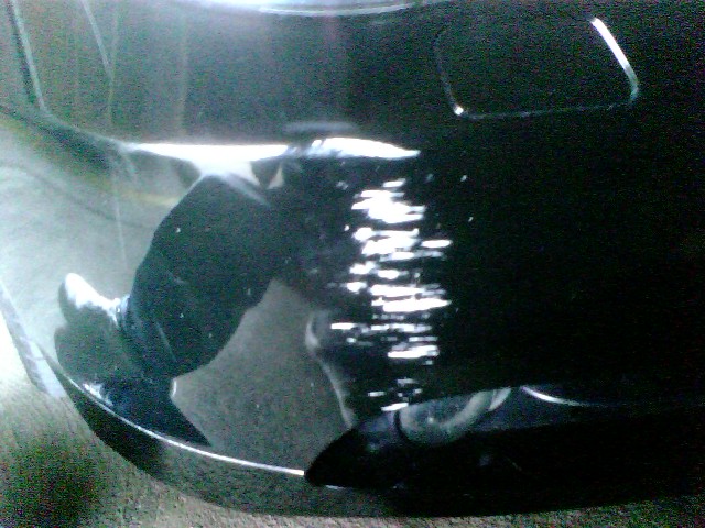

sorry for the crappy pic
i bumped into to a pole!!! its just white paint how do i take it off???

I normally wouldnt help a Lakers fan....but in your case Ill make an exception! If its just white paint from the pole itself, then wash the area 1st with soap and water, dry, then you can apply some rubbing compound. Its applied similar to wax. If the rubbing compound doesnt get it all off you can get a bit more agressive and wet sand the area.
When your done you're gonna want to repolish and wax the area.
Pretty simple process
GL...

try goo-gone with a microfiber towel.GL.

+1 for some rubbing compound. Autozone carries 3M rubbing compound and Turtle wax rubbing compound. Use a buffing sponge if/when you apply it
If that doesn't do it, a good detailer should be able to help you out....

I got all the Paint off easy thanks again guys shes good as new
