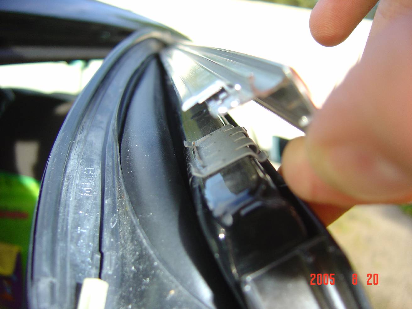

[/quote]Hi,
I just noticed that my right side back door has top alutrim getting off... that door is used second most after drivers door.
I opened trim a bit and found two pieces that were from the broken clips that holds the trim... see pictures... So one or two good slams might get them broken... have to go to the dealer have them replaced...
Second thing, the front passenger side the bottom side of interior trim is somewhat loose. The seal doesn't fit properly (arrow 2.) because trim tends to open a whole (arrow 1.) Don't know how to press this plastic trim more tight....
And finally I got the annoying door rattle (all doors) first time (8200km/ 7 months). It started day after I had the car waxed first time (ok dealer had it waxed when delivered but the car was brand new then) ... I think the rattle comes from the part where window's top part touch the frame (see picture: arrow 3.). If I lower the window 3-5mm the sound almost goes away.... so at that point I don't belive that it's the actual seals of the door causing this. But anyway the waxing had this think starting... Tried out some silicone gel but had hard time to get it into the hole...
All this in 3 days.... otherwise all well

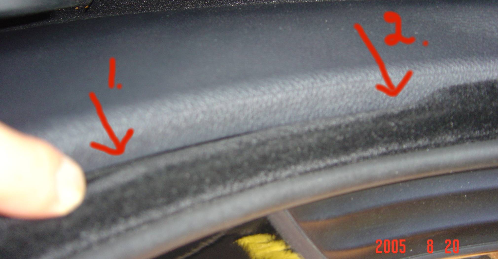

Go Petri to Laakkonen Espoo, I assume, and have those seals replaced.
There has been quite a lot of discussion about this matter.
I had the same problem with my old '04 E60 and it just brakes ones nerves.
Here's the BMW NA bulletin:
SI B 51 02 05
Body Equipment June 2005
Technical Service
SUBJECT
Squeaking Noise from Door Frame Area While Driving
MODEL
E60 (5 Series) produced up to 01/2005
SITUATION
Some customers may complain that they hear squeaking noises coming from the doorframe area while driving.
CAUSE
The movement between the mating surface of the flock covered door seal (felt-like material indicated by the arrows) and the surrounding roof panel produces a squeaking noise.
CORRECTION
In case of a customer complaint, replace all 4 door seals with the improved door seals.
PROCEDURE
Flocking material of the door seal has been improved. Install these improved door seals on all 4 doors of the vehicle.
Improved door seals can be recognized by the words "EPDM+Polyesterflock" (1) and a yellow dot (2) located on the bottom of the seal.
Notes:
Do not use "Carbaflo" on improved door seals.
The yellow dot is only a temporary indication during stock transition. This yellow dot will not be applied in future production of door seals.
SI B 51 02 05
Technical Service
SUBJECT
MODEL
SITUATION
CAUSE
CORRECTION
PROCEDURE
Notes:
PARTS INFORMATION
Part Number
Description
Quantity
51 21 7 057 507
Left front door seal
51 21 7 057 508
Right front door seal
51 22 7 057 509
Left rear door seal
51 22 7 057 510
Right rear door seal
WARRANTY INFORMATION
For information only.
[ Copyright ? 2005 BMW of North America, LLC ]
[snapback]161451[/snapback]
Thanks, I've read about those and now after reading the bulletin again I'm convinced about that.
I'll do that, first thing next week
It is just amazing that it really started after waxing... it's really sound from hell !
