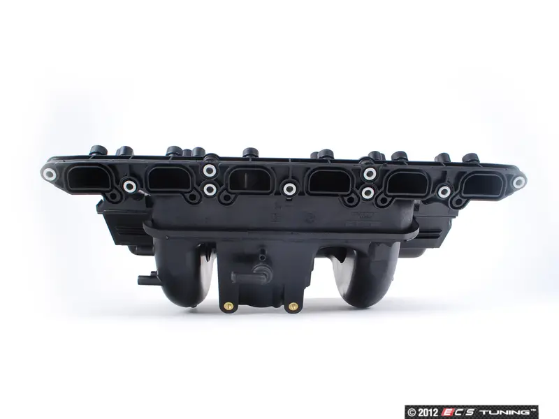

Here is a photo from ECS Tuning and I think I see the pieces there. It's the tubes where the air distribution piece sends the air into the cylinders at idle.

Yep I saw the same photo on ECS Tuning. I couldn't see the entire piece and so wasn't 100% sure but it looks to be it.

If that part that dropped to the bottom of the engine when removing the intake manifold is in the ECS picture that is posted, you would have figured out very quickly when looking at the manifold there was 7 more of those parts still stuck to the intake manifold (but you didn't).
Is it possible that someone dropped that part years ago into the engine and it just fell out recently?

If I remember correctly, they have little rubber seals around them so are in somewhat tight. When I initially pulled the manifold off I didn't even realize there were separate pieces there, thought it was all one casting. Then I noticed while removing the gasket that those little guys would move a bit, but none of them fell out for me.
