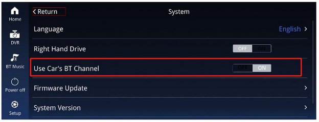

Purpose being, you need to connect to your car via Bluetooth streaming for best sound quality. You would then connect to the Linux unit which leverages the Bluetooth connection you made with your car to transmit the signal to the COMBOX (The fibre optic connection you are seeking)>hifi-AMP>Speakers.
For my car, I have a 2010 which came with a CIC unit, HiFi. All I did was purchase a COMBOX, coded it for an E60. I then made sure that I was able to stream music from my phone to the car. Once I verified that connection, I then purchased a Linux unit specific to the CIC (4 pin LVDS connection, your unit may have a 10 pin LVDS for CCC systems). Within the Linux unit itself, there is an option to use the car's Bluetooth:

Year I understand what you are saying. Honestly, this was the very first mod I did to the car, and it was also an urgent necessity because the road network where I live is quite complicated, and E60 doesnt really allow a good phone-mount location. I only researched on the Compatibility, screen being good itself, and a study bitween android and linux systems. With time only I kinda started feeling lacklustered with the audio quality. When I switch to CD or Radio even, the Audio quality is substantially better with the now-almost 18 years old Harman Becker amp.
Now looking at the image you have attached, I remebered that I also do have that Bluetooth option on my screen (I think the core firmware of these units are mostly the same)
I did try it out, but it didnt work for me, probably because my car does have bluetooth but only for calls.
Linux CIC screen with Bluetooth menu
Linux CÇC screen with Bluetooth menu
(Scratches are on the screen sticker, not the display itself - for all OCD guys like myself )
Since I am at this stage now, what would be the best option to reach to the optimum sound quality?
  1. Is it possible to code or emulate the OEM BT module to somehow receive Phone and Music? (dont want to use an AUX to Bluetooth or an FM transmitter which will hinder my goal even further)
  2. Or will a RCA to Fiber converter (and use the CD changer input) will work? Coz COMBOX is no use for me at this stage for its functions and cost, I feel.
