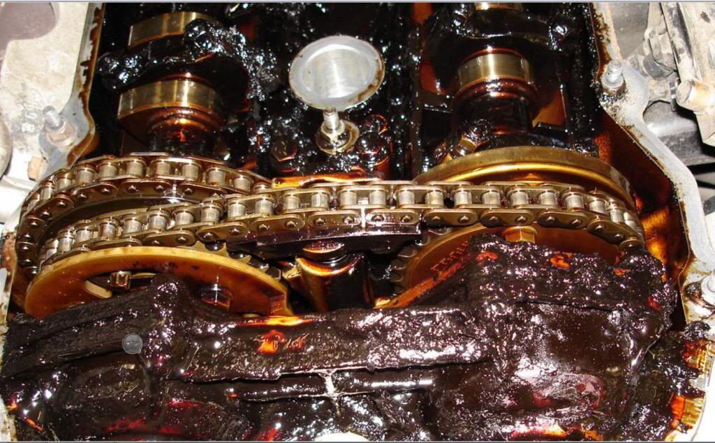

It is amazing what an internal combusion engine can endure and still keep functioning:
That sludge built up over years and miles. Throughout its lifetime, it functioned at a level far below its spec's.
Have a shop use a borescope to check for sludge buildup in the cylinder head area if you're concerned about the possibility.

I consider frequent oil changes are cheap insurance to prevent oil sludge. I do what I can to prevent major disasters.

Ouch! Never good to see that "OIL" warning light. Never.
You really need to get on top of checking that oil more often and probably changing it as well.
Put a date into your iphone to "check oil" each month. Do you know how to do this? If not, go to a full service station and have them check it for you.
Sounds like you're burning oil or going forever between oil changes.
Look at the photos of oil sludge buildup and then begin a program of changing that oil more often.
Let me suggest you purchase one of these and have your mechanic install it during the next oil change:
http://www.drainplugmagnets.com/ It can help to keep that oil cleaner for you between oil changes.
But it won't prevent carbon and varnish buildup which is probably occuring on your car.
BG has a professional cleaning flush that you might want to consider. Indy shops charge around $200 for it and you might be a prime candidate for it. First make sure that they run a borescope to see if you don't have large amounts of sludge built up. If so, sell the damn thing!
