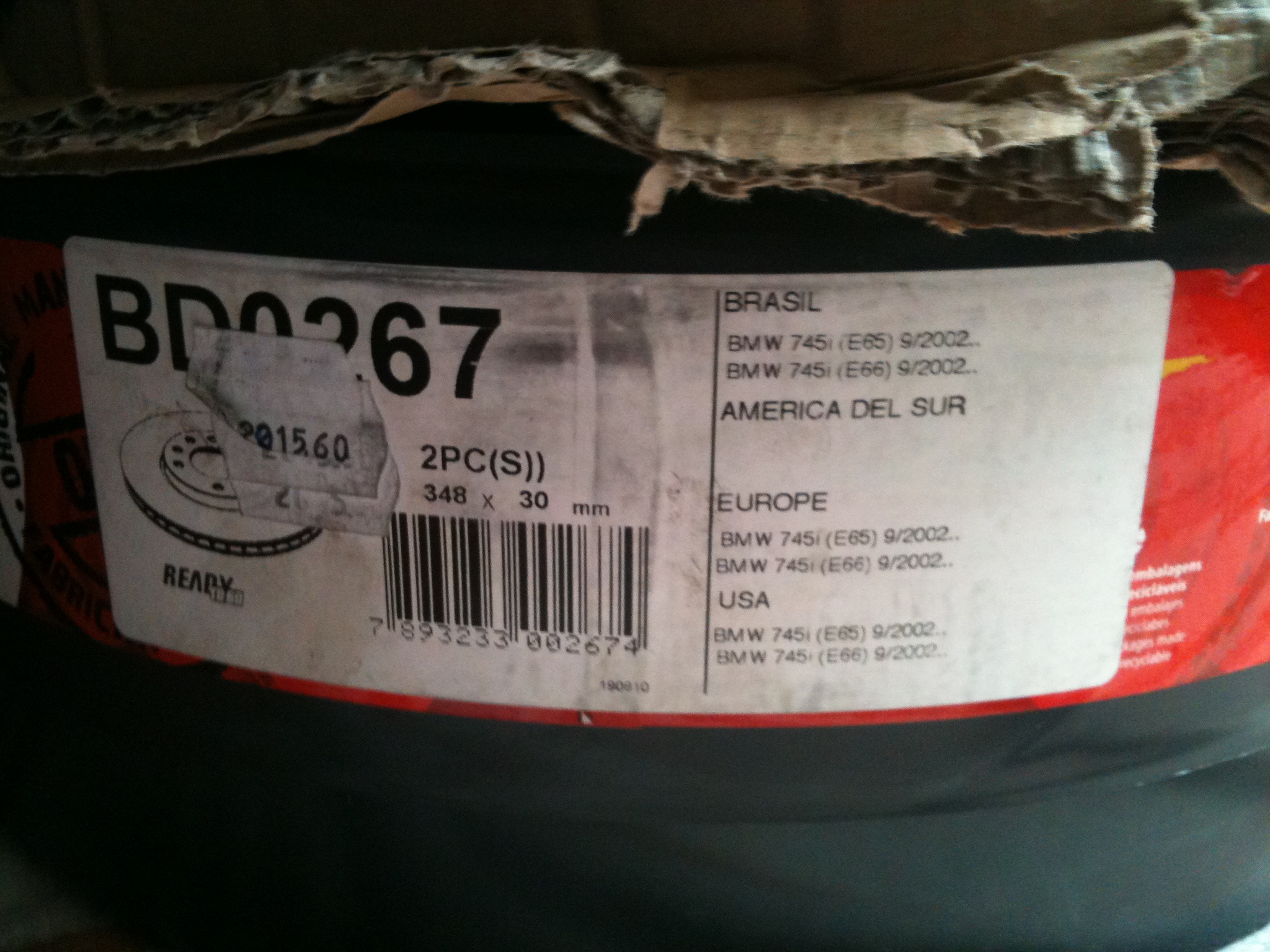

Hi guys,
I bought aftermarket rotors but I got sent rotors which were the correct size (348x30), but they were too deep, which meant they didn't fit and couldn't turn.
I noticed afterwords that it said 745i on the package... So I was wondering, eventhough the size is the game (348x30), de depth is different. Does the 745 E65/E66 use different sizes?
What are the exact differences?
Thanks in advance!
Attached Thumbnails Difference in size rotors 545i and 745i (E65/E66)-img_1084.jpg

Its the hub thats different and also how the caliper mounts on thier suspensions. Same thing happens on M5 vs Alpina same size disc but hub is off a few MM
