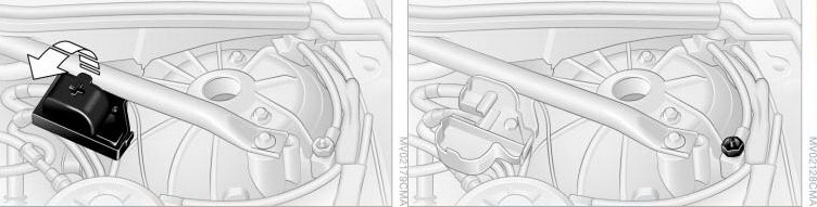

Connecting the jumper cables
To avoid personal injury from sparks, always observe this sequence when connecting jumper cables.<
The symbol + is embossed on the cover. Your BMW has a special nut as body ground or negative pole.
1. Open the cover of the BMW starting-aid terminal. To do so, pull the tab
2. Attach one end of the jumper cable plus/+ to the positive terminal of the
battery or a starting-aid terminal of the vehicle providing assistance
3. Attach the second end of the cable to the positive terminal of the battery or to a starting-aid terminal of the vehicle to be started.
4. Attach one end of the jumper cable minus/? to the negative terminal of the battery or to an engine or body ground
5. Attach the second end of the cable to the negative terminal of the battery or to
the engine or body ground of the vehicle to be started.
