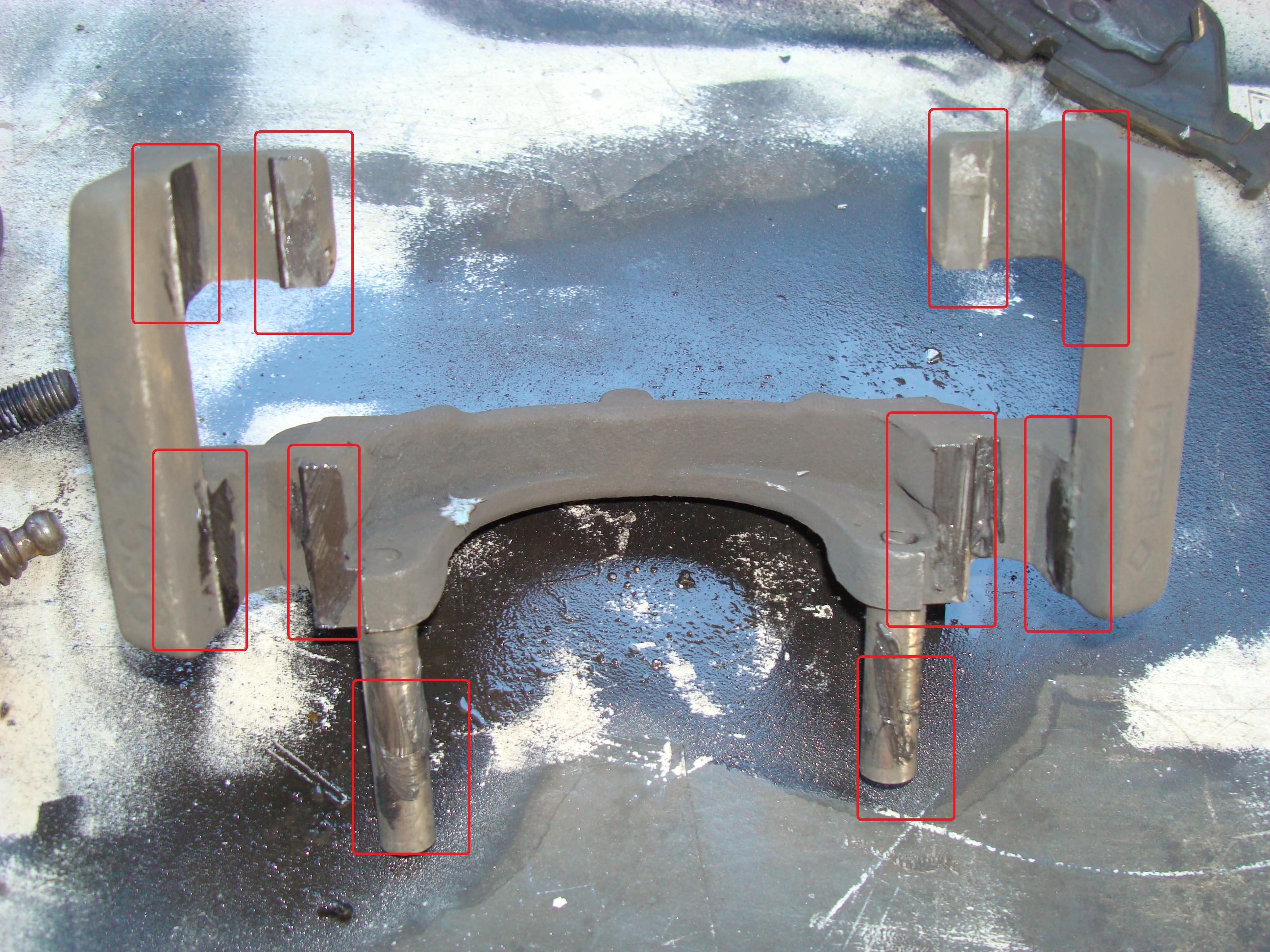

Originally Posted by 525iEnjoy
Dont use stop gunk or pad glue.. Anti-seize and auto marine grease. I personally always anti-seize all metal to metal contact where the pad mounts and slides, the backing plate all get anti-seize, the caliper guide pins get some auto marine synthetic grease. And not one squeak and I run stock pads on my M5 setup and even on my stock setup..
Shoot some brake cleaner on the disc and close to pad in the morning or when cool and see if that helps
I agree...
But I like the ceramic pads for the street because I hate the dusting of the wheels.

I agree...
Attachment 116079
good picture. I even put seize between where you have the red squares.
