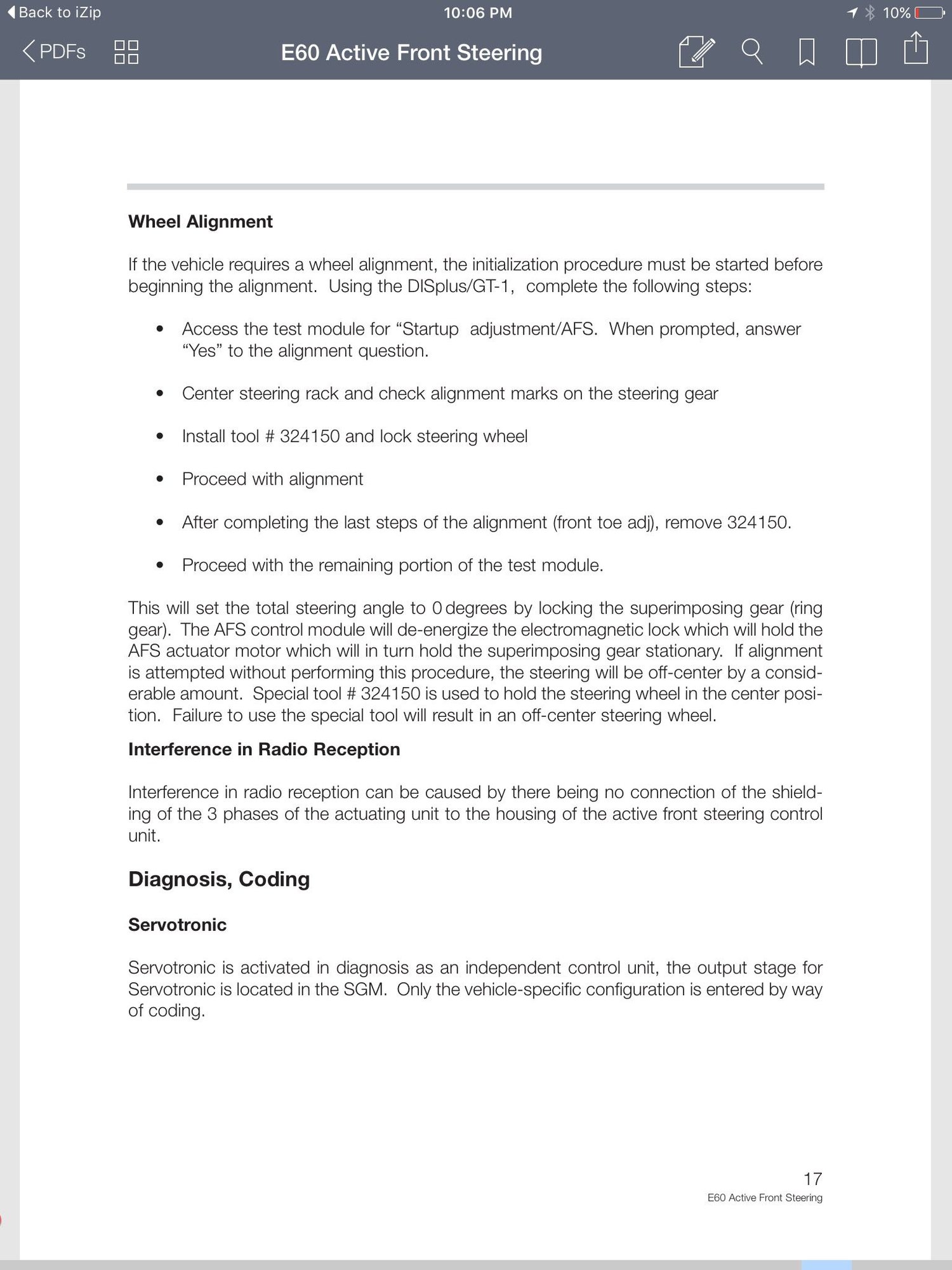

Engine: N62
Straight from BMW shop manual.....

Does that mean the active steering fault can come due to improper alignment?

No, just would straighten your steering wheel if done properly.
