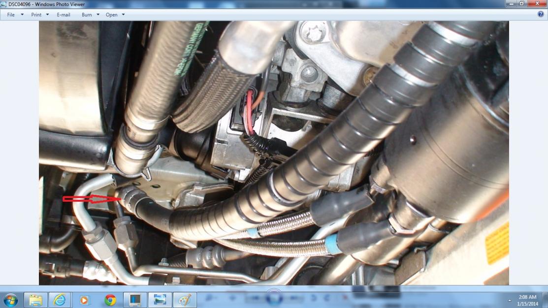

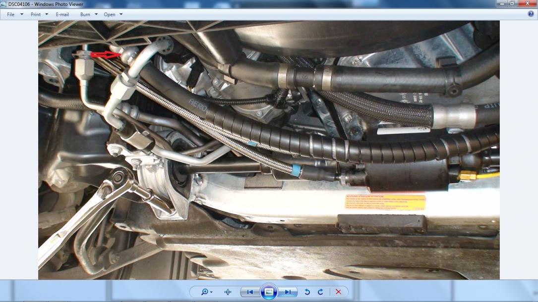

Hey guys,
I really don't want to break what's not broken! At the same time, I want to replace the water pump and thermostat before I get stranded on the road at around 82,000 miles on the car.
After looking at all the hoses, I am starting to get dizzy and unsure. Can someone with good eyes and more experience (than me) look at the attached link/pics and please tell me what this hose (see red arrow) is? If I disconnect it, do I simply refill the power steering reservoir with CHF 11S and bleed it after I reconnect it? Do I need to put any kind of liquid gasket or sealer on the screw? Are there anything other steps that I should know or do?
And yes, I have seen other threads and video about replacing a water pump on an N52 engine. Unfortunately, my car does not come with the rubber hoses that can bend and be set aside like the samples I saw. Thanks for your understanding! ;-)
RealOEM.com * BMW E60 530i Power steering/oil pipe/dynamic drive
Thanks!
Daniel
