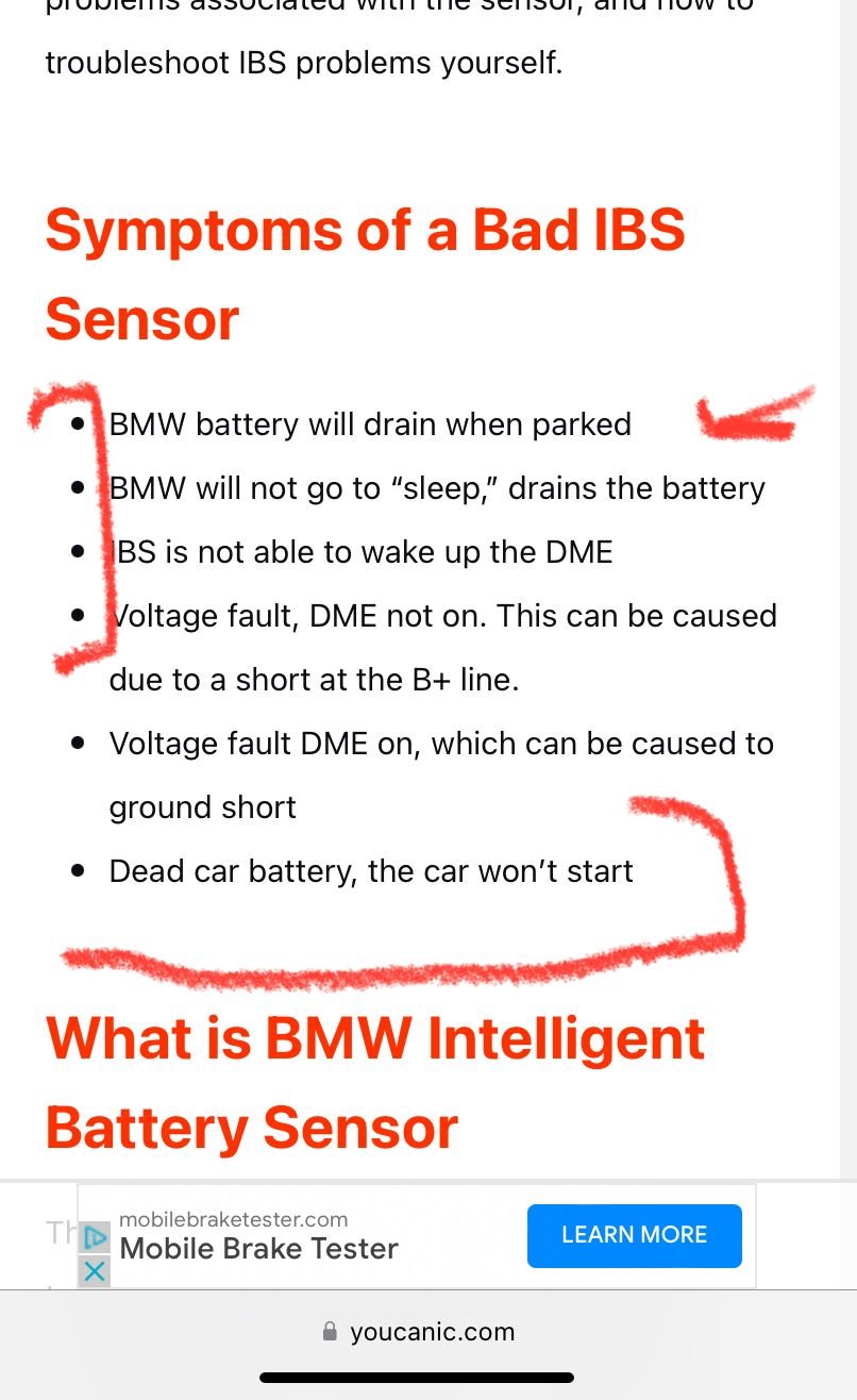

Please see what I’ve read below.
thank you
This is what I read among many other post!

Mine would occasionally display battery discharged notifications on the iDrive. My car was sleeping though. Try not to get confused with battery drained. If there is insufficient charge, it will misinterpret that as a drain when it's not.
