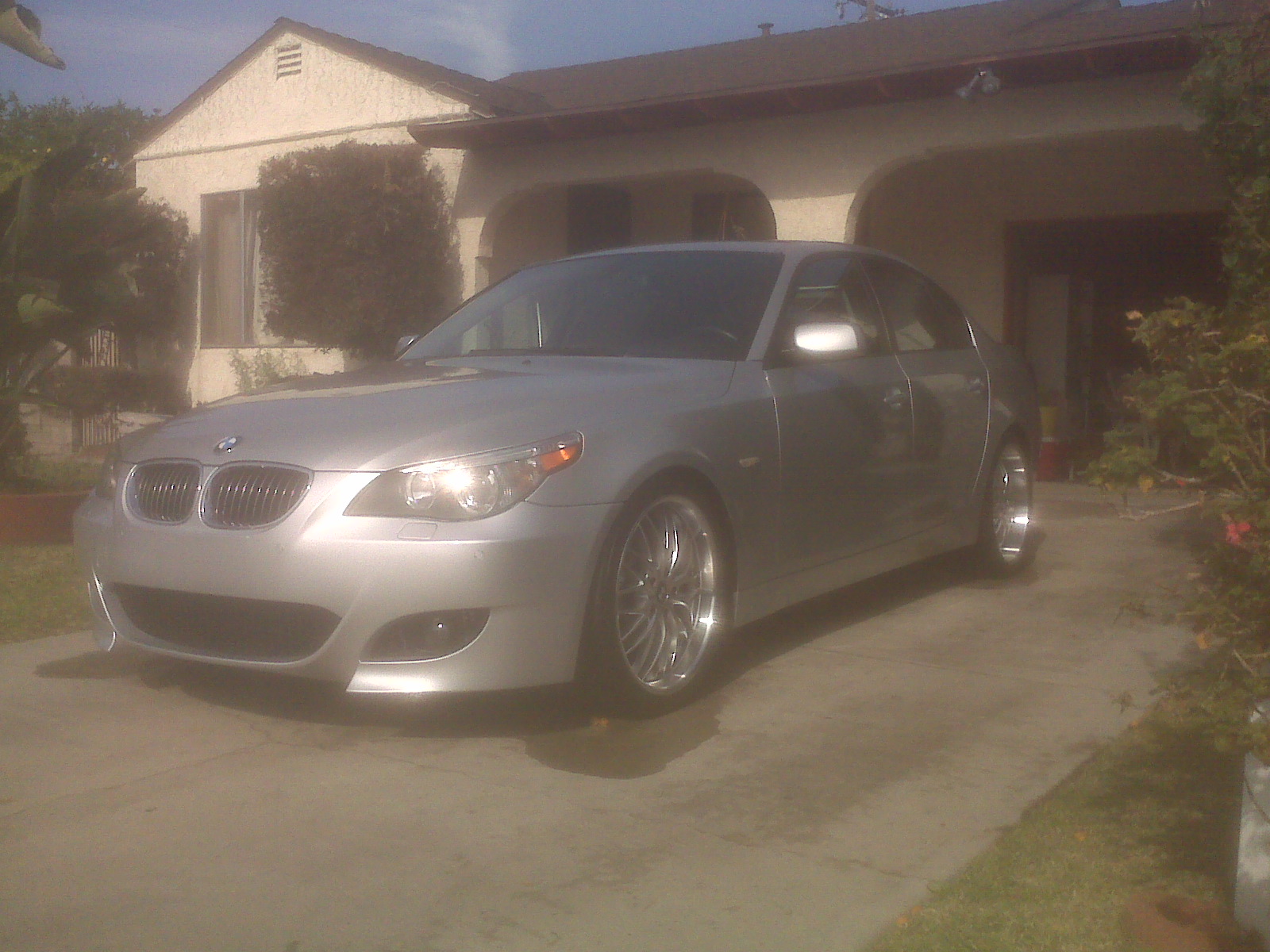

I have 9.5" in front and 10.5" in the rear, pic below after giving my car a nice little spa treatment a few moments ago:
Attachment 116788
A friend of mine successfully grinded down the [font="'Arial Black"]interior part of the wheel that hooks up with the rotor/lugs by 3mm. This solved my scraping issue [/font]and the car rides and handles beautifully now.
I want to see pictures where the scraping was.

I didn't take pictures but the tires were scraping up against the lip of the fenders in the rear when I would hit a bump, or if I had people riding in the back of the car. I believe the offset was +20mm

So you had the offset changed by milling the mounting pad?

Yup, pretty much by 3mm

When I first put my wheels on they offered me to mill the wheels to decrease offset so I didn't rub - I refused, much easier (and cheaper) to roll the fenders to get the clearance I needed
