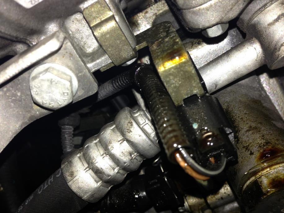

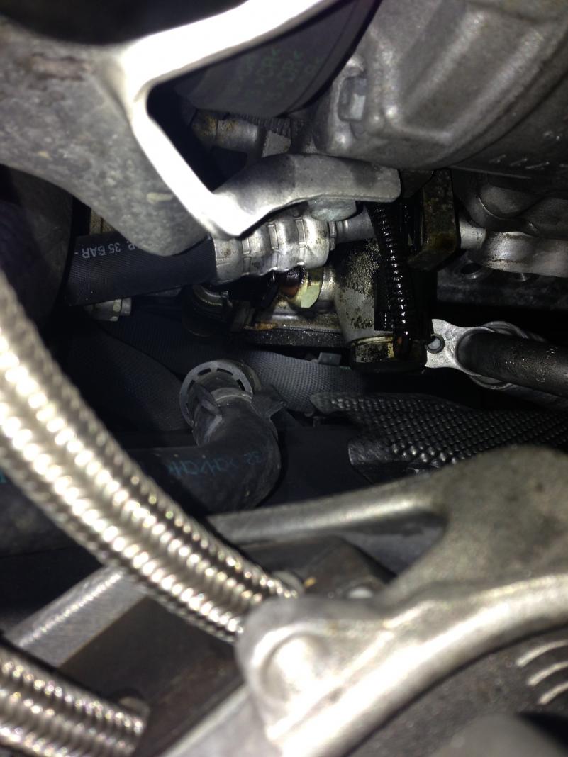

Took off the undercarriage cover to get familiar with the parts to get ready to tackle alternator bracket gasket. Under carriage had oil on the passenger side. I cant really tell if its dripping down from the upper timing cover (looks like it could be from a corner isnt that wet though, vacuum pump or if it may be the oil pressure switch. Im not getting any fault messages for the sensor. It is wet down there. Guess Ill be busy this weekend. Also what is the best method for getting the grime from old oil off these parts when I go in to do these repairs?

Very likely from oil pressure switch and/or the vaccum pump.
After wiping off the excess oil, you can spray brake parts cleaner for cleaning up the grease/oil stains.

Here is a better pic...

Yes, that's the oil pressure switch.
