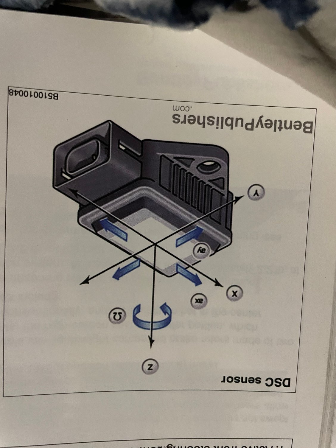

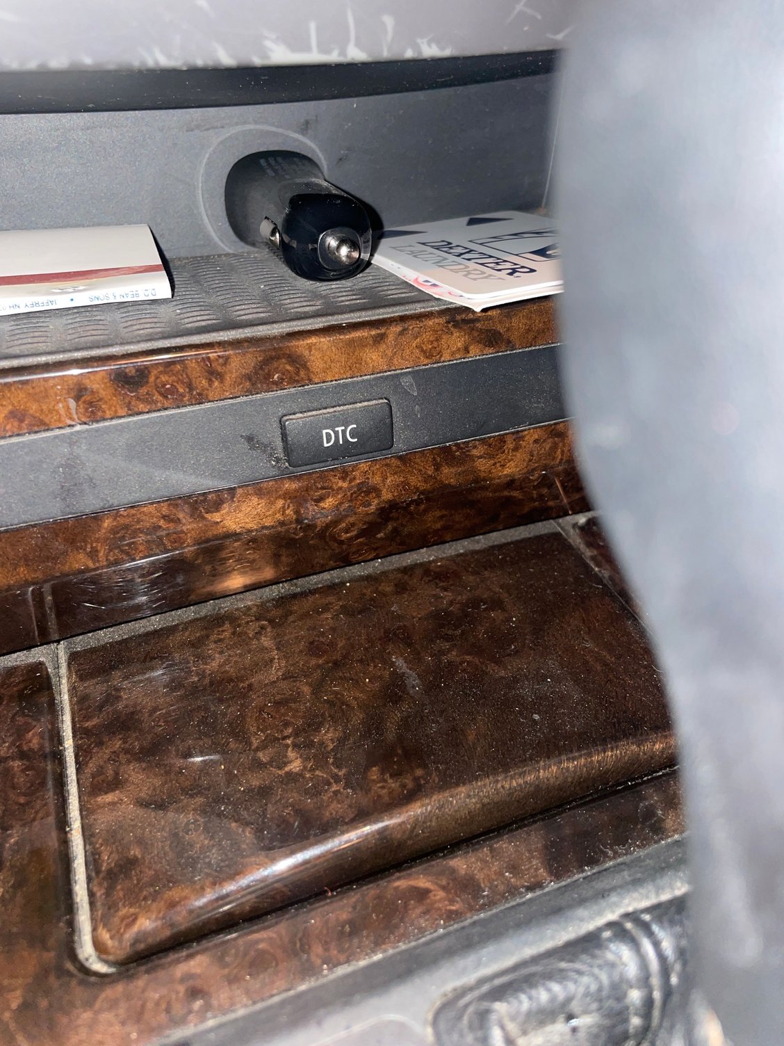

please see attached images.
if you’re using this button, it has nothing to do with codes.
another helpful secret is that with a scan tool you can access a German language menu by pressing and holding the odometer reset button.
it seems crazy at first but the manual shows they use both DSC and DTC buttons for the same thing. .
