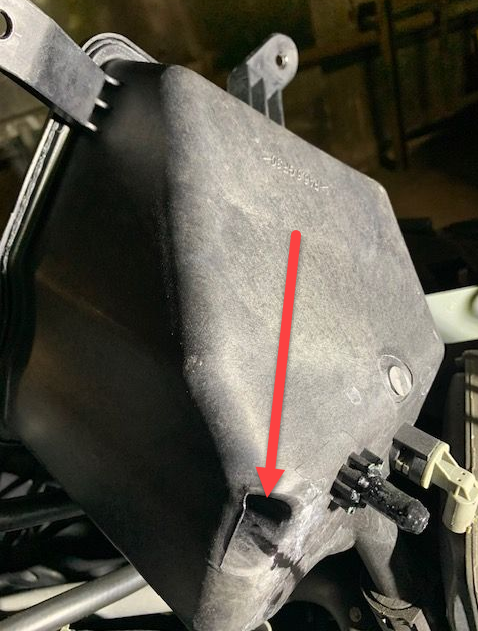

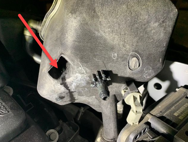

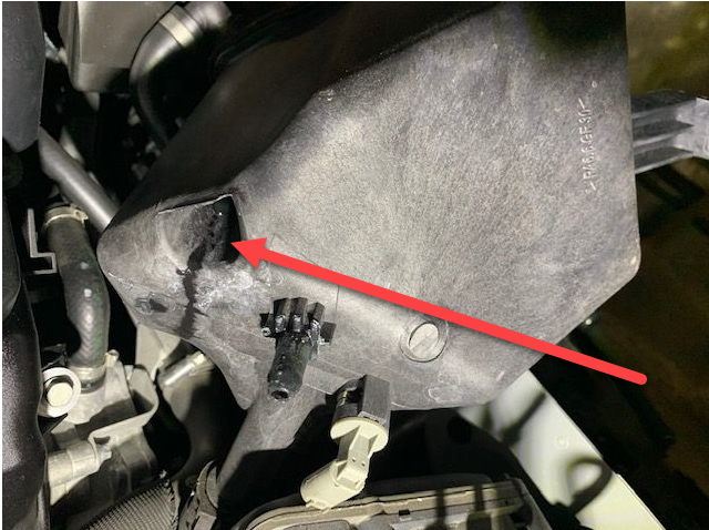

Had hard time finding out where is coolant leaking from, every 3-4 months have to add about 1-2 quarts of coolant.
Finally located, with engine hot removed the expansion tank mounts and noticing under the tank dripping coolant from the bottom hole.
Last year I replaced the expansion tank cap just as preventive measure (so cap is fairly new) but it does not appear to be normal having this much coolant loss that happens at engine normal operating temps.
Would it be safe to conclude the tank needs replacement?
img host

The tank is a weakness in these cars. Everyone has had to replace it at one point in time. Replace it and be done with it
I just ordered the tank, will use the almost new cap. I thought it is only the cap that deals with pressure sensitive coolant release adjustment but based on the amount of coolant I had to add this does not appear to be normal and somehow has to do with the tank itself.
Still not clear how does this process work in terms of releasing coolant at high pressure levels, between the cap and the tank?
Is it possible that even the cap is good the tank can be defective causing coolant loss via that hole?
I can say this was kind of pain to detect as it leaked under the tank (not visible) and every time coolant would dry very quick from heat.

If your tank was original from new, it was due for a replacement. The cooling system is pressurized while the engine is running, and when the tank is nearing the end of its life, around 10 years, the plastic cannot withstand the high pressure anymore, and will develop cracks. Most of the time, they are on the side and is visible with dried blue coolant stains. Yours happened to crack on the bottom.
Ideally, this part should have been made out of metal, but beans have to be counted.

Just to clarify, there is no crack at the bottom, coolant is dripping from very top point through that bottom hole. When checking with light it appears there is a small hole at the top, maybe that is the same valve hole that releases coolant at very high pressure levels in case of overflowing the tank.
Currently have 130K and this is original expansion tank, 2008 550i model.

At any rate, you must replace the tank - it is leaking, one way or another!. A hairline crack is not visible when the tank is cold. The cap is what relieves the pressure, not some orifice in the tank itself.

Tank is to be delivered tomorrow and I should replace it by this weekend.
The cap relieves the pressure but is that extra coolant also dripping via same hole as shown in my pictures?
